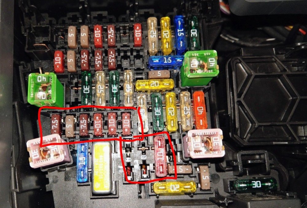

The following rows r switched power, i.e. with ignition.
I used #47 for mine ....
