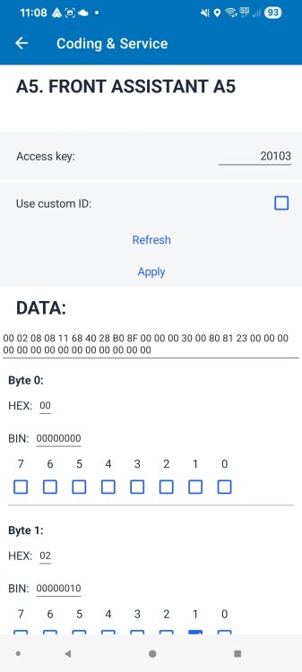

The problem is all instructions I found includes i put text values in coding, adaptations. I can't see it. All I see is binary code. So I found coding or transfer instructions to just bytes and bites.. Something missing....
This is all I can see....

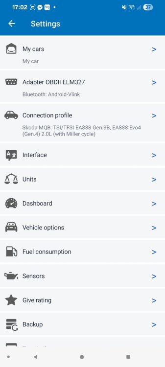

Should I keep this profile or tried other one? Trying to see how to get acces to more coding options...
profile is fine so long as it matches your engine code.
Can you press on the string under Data: and type into that or is it just a display of current coding?
Yes, I can type in and I modified it few times. So every instruction using adaptation need to be converted in binary coding. But yes, I can edit coding.
I dont understand what you mean by "every instruction using adaptation need to be converted in binary coding"
I have not dont much long coding but I assumed you type or paste into this field and hit apply.

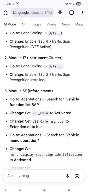

I'm new to coding so I might not be familiar with terminology. I had some instructions to code lane assist or sign recognition and it needs finding string of text and choosing "activate" or "" enable". I can't find it. I can see numbers. So then I ask Gemini to convert this to raw binary code.
Like this : I can't find it in my long coding
I tried @Cairus code, wouldn't change anything. Still "currently not available"...
As far as I’m aware. You paste the whole string into that field and tap apply.
Or you can select individual bits if you only want to change one at a time.
AI is confidently wrong about a lot of this stuff so I would be wary of following its instructions.
