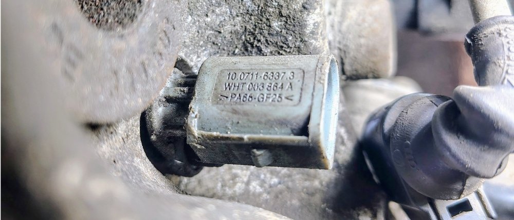

Replaced rear left sensor and wheel bearing (magnetic ring mostly disintegrated).
Now 0 wheel speed on rear left.
10.5 volts on FL, RR and RL, no great but others are still working.
Installed the new rear left bearing to rear right (with original sensor), can still get reading from rear right. Putting original rear right bearing on rear left, no reading. Doesn't seem to be an issue with wheel bearings magnetic ring.

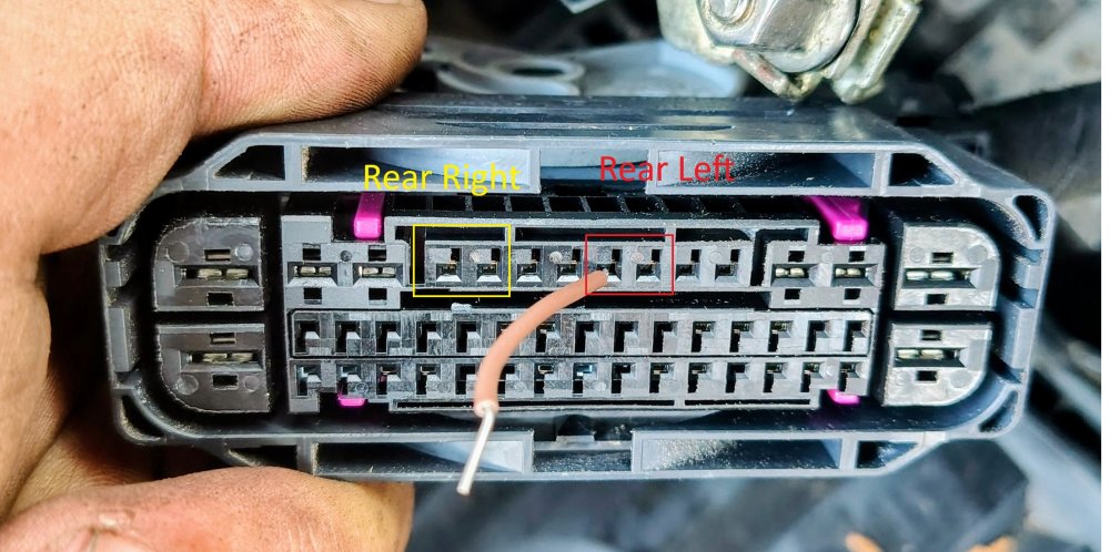

Checked resistance from ABS cable to RR and RL sensors and get 1 ohm, not load tested. I doubt its the cable as was receiving a reading before.

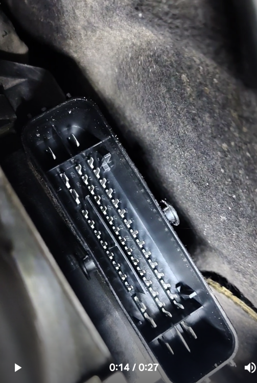

Put the ABS cable back into the ABS module and then got a handbrake failure. Removed and re inserted the cable and issue remained (no damage to pins). Only disconnecting and reconnecting the battery a couple of times fixed it. (Removed battery to access ABS sensor)
At a bit of a loss as to what is causing the issue, looks like either the rear left sensor, harness or ABS module?
Will try using the rear left ABS sensor harness and connect it to the rear right and see if i can get a reading this way. To rule out the rear left wiring harness.

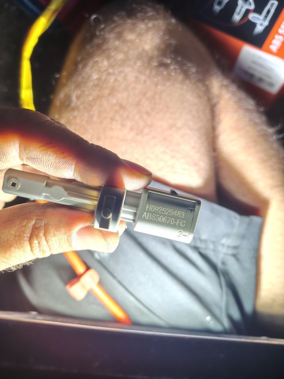

Using this replacement sensor, 412W0128 RIDEX ABS sensor Rear Axle both sides, without cable, Hall Sensor, 2-pin connector, 37,8mm, 75mm, D Shape | AUTODOC price and review
And another from GSF parts but no luck

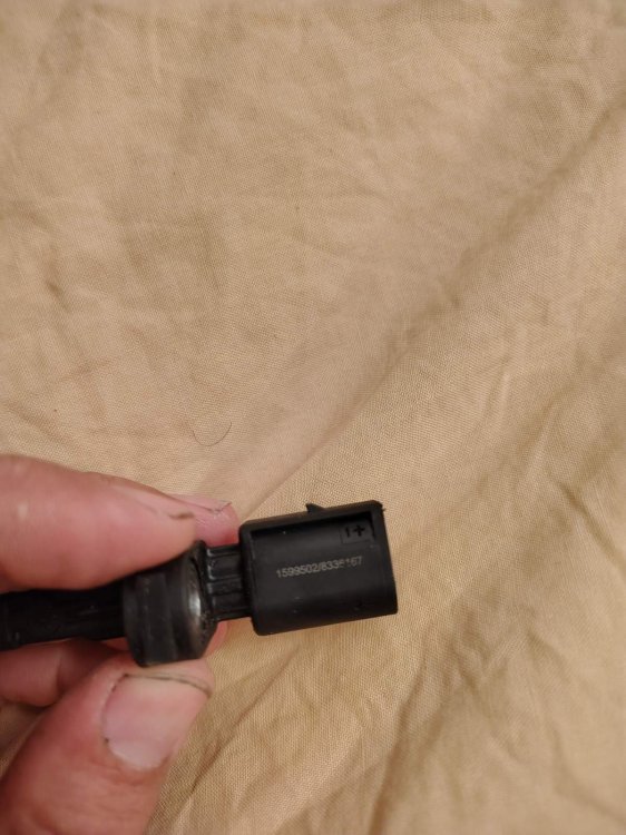

Original sensor on rear right, has to drill our the rear left. So cant just swap them over
I’ve had 2 x new sensors in the past which turned out to be faulty - only buy reputable brands, costs more I agree but……..

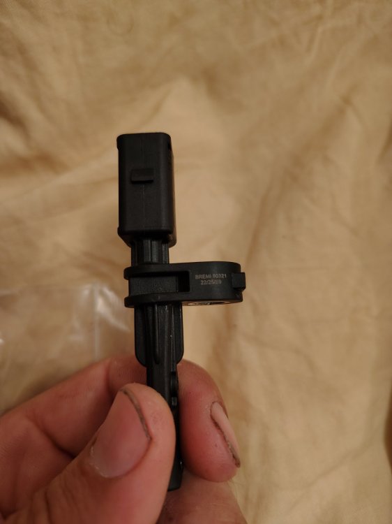

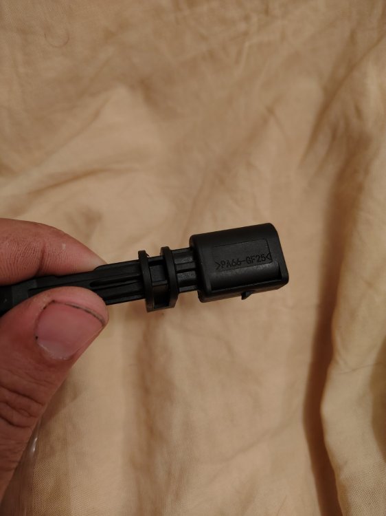

Got this sensor from GSF, BREMI - Wheel Speed / ABS Sensor - Rear Part: BRM50321
BREMI - Wheel Speed / ABS Sensor - Rear | GSF Car Parts
To try and rule this out, didn't seem to make a difference. That was a £35 sensor
Seen a £90 Bosch sensor at eurocar parts, might give that a shot.
