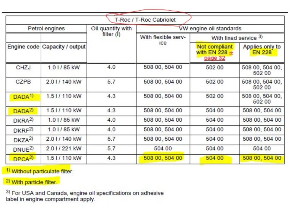

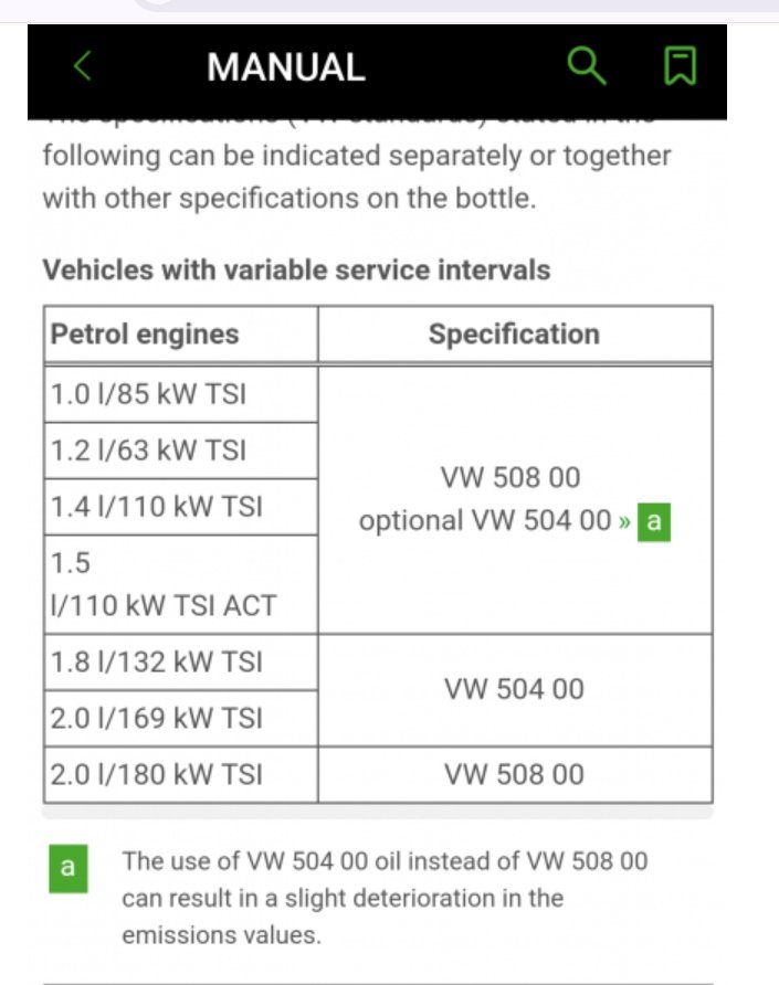

I'd recommend checking the owner's manual first to make sure you use the correct specification. If it calls for VW 504.00/507.00, oils like Castrol Edge, Mobil 1 ESP, or Shell Helix Ultra are all solid choices. It's also worth replacing the drain plug washer when you change the oil and filter.

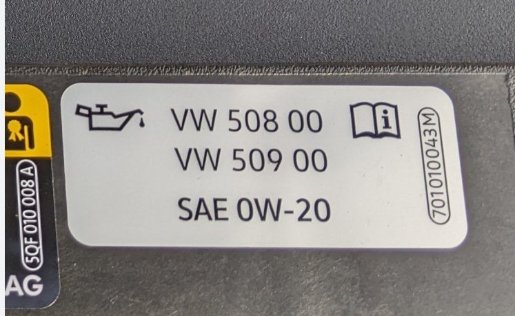

The recommended oil by VW / Skoda for a 1.5 TSI ACT since 2018 is VW 508 00/ 509 00 so 0w 20 FS IV............ Not VW504 00 / 507 00 , 0w 30 FS III or 5w 30 FS III. PS. Personally it matters not if from ASDA, TESCO, COMMA or anyone else as long as to spec and from a trusted supplier. Nothing special from CASTROL and UK dealers get from TPS Fuchs oil / Quantum.
