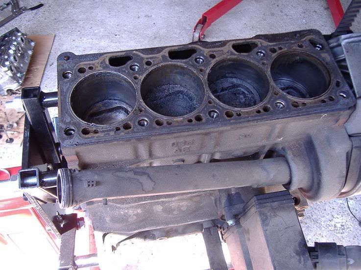

finally got round to having a proper look at this engine today! :o
it is a terrible state inside, she looks like she's never seen an oil change since it came out of the factory. it looks(and feels) to me like it will need a rebore, but i will consult an ex-collegue of mine to see what he says.. i think the first thing to do after stripping it completely down is to give the bores a quick hone to see if they are going to clean up... failing that it will be a rebore... which isn't the end of the world but it would mean i would need to buy new pistons which i didn't want to do, my plan was to just re-ring the existing ones......
next i had a good look at the cylinder head, crusted up oil in the top made it difficult to remove the hydraulic lifters. also the collets were jammed on solid, they aren't damaged, just 'glued' on by the grotty oil...
even the valves didn't want to come out without a fight:D
but all in all, this head is in very good condition, i going to have it chemically cleaned....

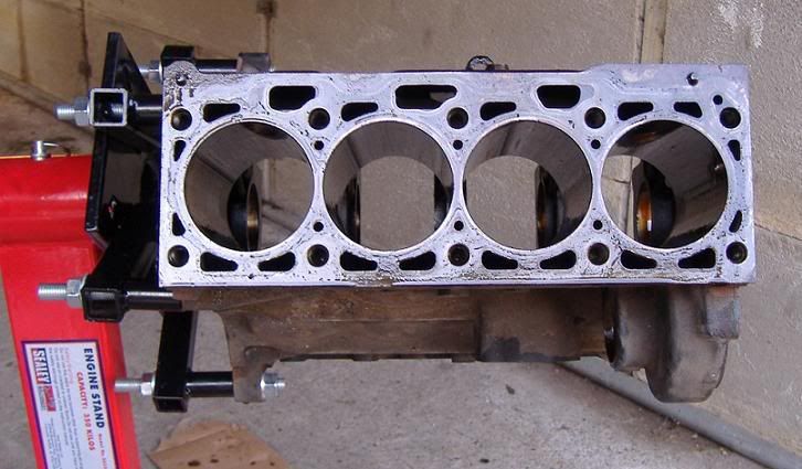

now the engine is totally bare
i've had a very close look at the bores and measured them etc. they are actually going to be ok after all so i need to take it to the machine shop to get the bores honed and the deck surface ground to give a nice clean surface and the right cross hatch pattern to aid the bedding in of the new piston rings, plus it needs to be spotlessly clean for the rebuild so it needs to be de-greased and thouroughly cleaned as well, and then painted if necessary
