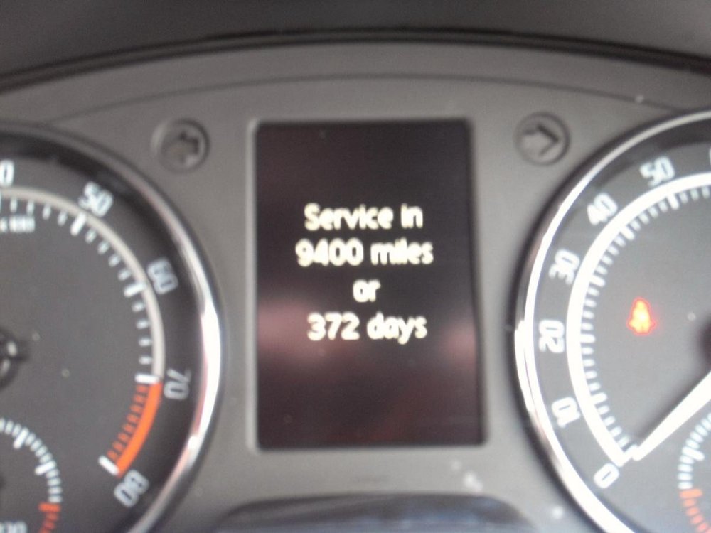

Do not rely on any warning messages or warning lights on the car, often they show when things have got further than is best, be proactive by preventing most warning messages and lights from coming on by keeping the whole car in at least reasonable condition if not good condition.  Warning lights in the past were often known as "idiot lights" sometimes unfairly, but not always.  Cars have complex computer stuff on them now but again many of these these shouldn't be relied on as when to take actions of maintenance (and servicing).  The oil service message is more of a reminder than any real measure.
For the engine oil and filter change on a 9-10 year old car you don't know the history of I suggest unless you only do lots of motorway driving that you change the engine oil and filter at the annual mileage (9,400 miles) or time whichever is soonest.  Also bear in mind of course that there are far more important components and systems on the car than the engine, brakes, steering and suspension (all three include the tyres) safety electrics (lights, horn, wipers, etc,) and windows and mirrors.

9,400 miles

@nta16  You have a typo   '9,400'
Thanks, I blame the cheap keyboard, it has sticky keys that often print none or twice, plus the battery died very shortly after that (I can use a battery that's too low for digital stuff and the keyboard will be happy with it for a very long time and wear it right down, bit like my TV remotes) - plus of course I'm a poor (slow, one-finger) typist. 😆
