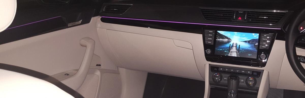

Get your colours out for the lads! So, the possiblitly of changing the default internal ambient lighting LED to anything you want via VCDS  was intriguing but potentially rather time consiming. So I thought how about a thread dedicated to you tinkerers to show off your custom colours. Maybe save some folks some time setting their preferred RGBs depending on trim colours.
Here's mine for a beige L&K interior with a 'Plum Purple' setting - Red: 102 Green: 0 Blue: 102 (I found a full purple setting too bright):
Edited by l4wrence
I've gone with plain old purple for the time being. Red 255, Green 0, Blue 255.
Compliments the beige nicely, as does the 'Plum Purple'  :thumbup:
Here's mine for a beige L&K interior with a 'Plum Purple' setting - Red: 102 Green: 0 Blue: 102 (I found a full purple setting 128:0:128 too bright):

Here's mine
How did you get the screen saver on the Columbus?
See pages 14/15 of the Columbus Owners Manual as long as you mean the clock display that is.
Edited by Prykey
It's the Columbus image viewer. You can have a slideshow whilst still driving (unlike video or DVD). It's just a bunch of wallpaper I got for my PC in 1080p.
