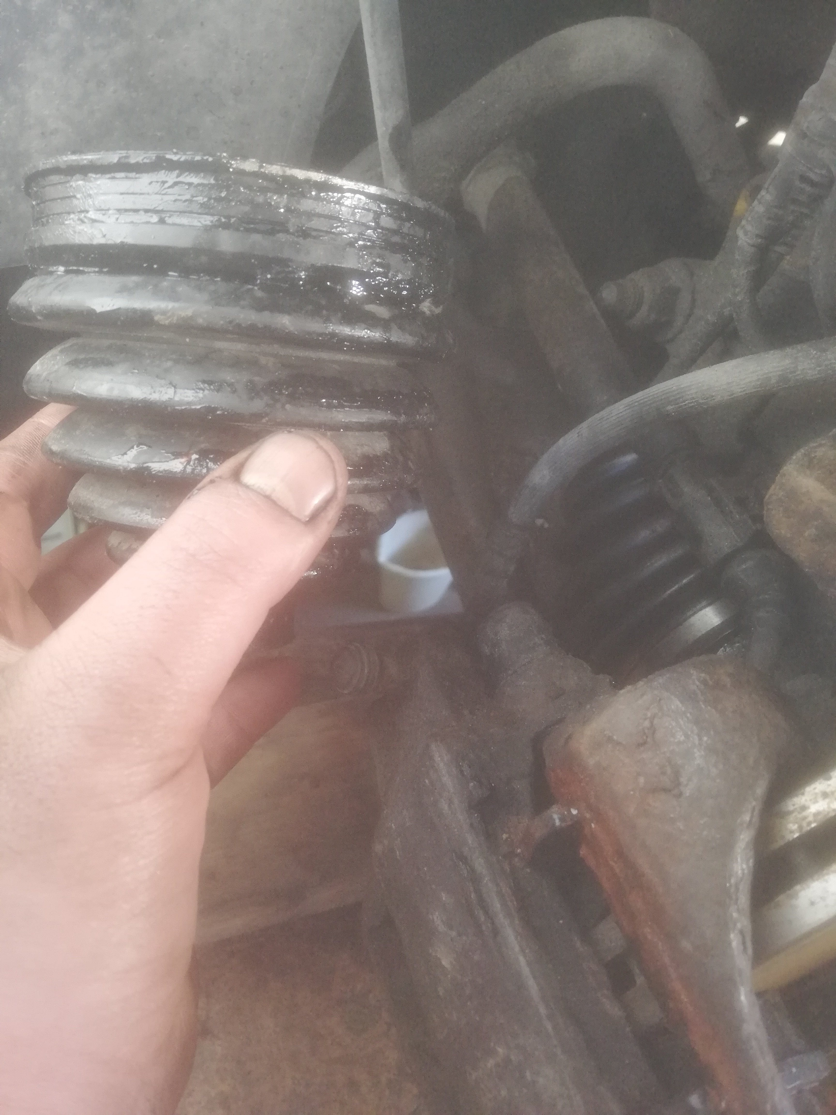

Left CV joint part number?
Thanks for the help finding the part number @UrbanPanzer, i just changed the boot today but almighty was it a messy job, and i pray that i managed to tighten the clamps enough. Next time i'm ordering a complete axle instead:P

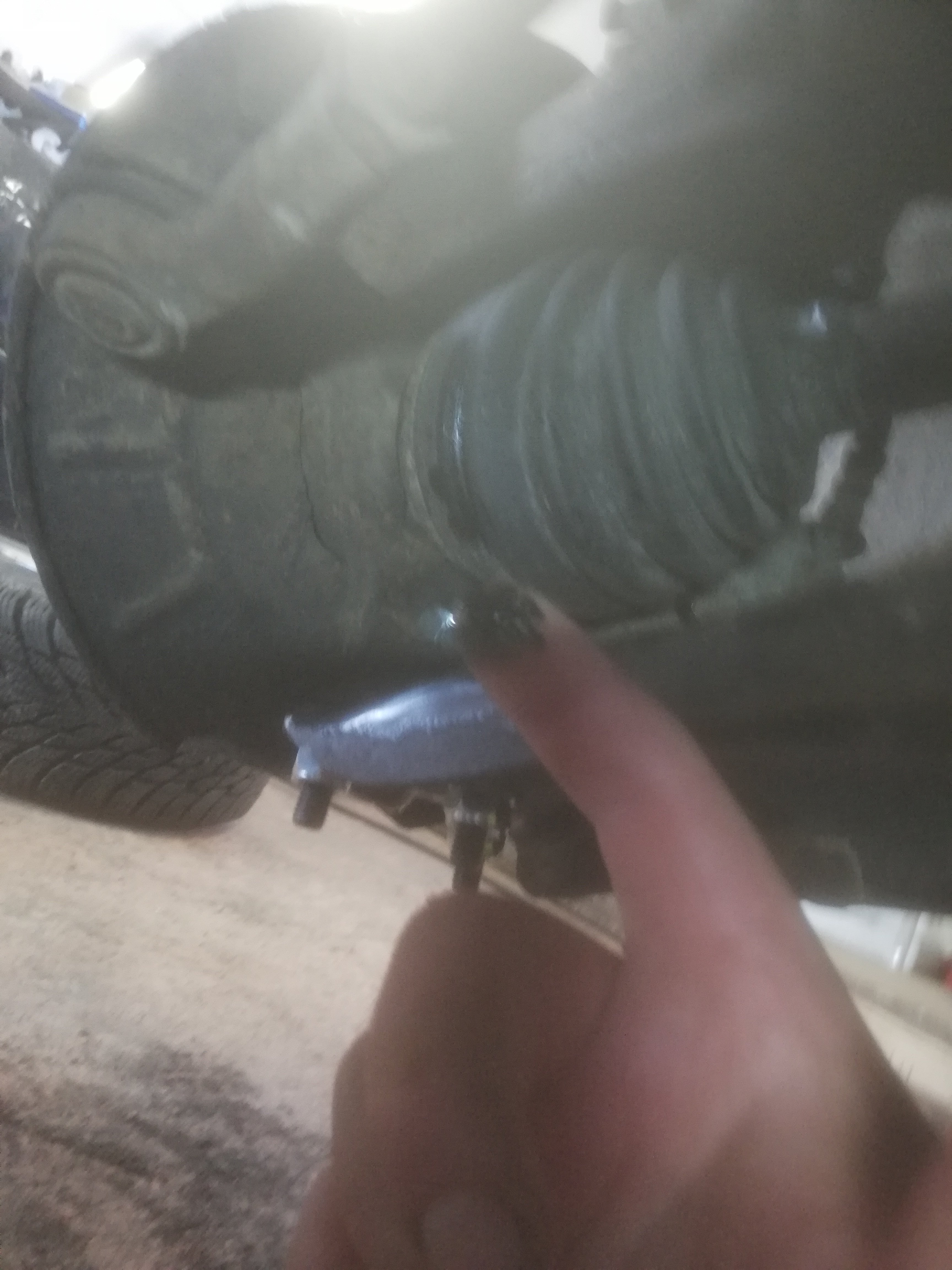

So i nicked a small hole in my left CV joint boot, i been searching the parts catalogues and the workshop manuals but they return wildly different partnumbers. Its the car in my description and its a LHD model if that changes anything. Can anyone help me find the part that i need to just change the joint? Should i just let the shop do it? I Fixed the boot with some superglue as a temporary fix:P
