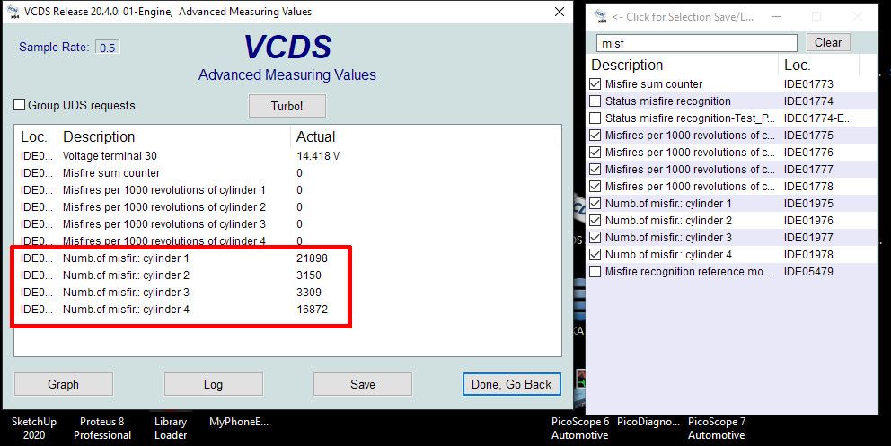

Reset Misfire Counts
If not in turn, is it possible to reset all misfire counters at once?
Hi Can I reset the misfire counts for each cylinder in turn ? How?
