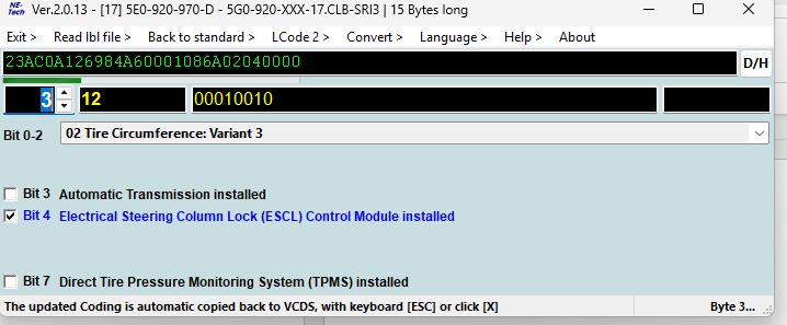

  8. Tested using cruise control, I noticed that my speedo was reading 10% down on my relatively new to me octavia with new 225/45 R17 tyres. VCDS -> Modules -> Instruments -> Long Coding Mine was originally set to option 0, option 1 made no difference, option 2 has made the speedo very accurate, I estimate reading 0.5mph lower than GPS. There are a total of 8 options. Since the change naturally the MPG has increased by 10% as the car is accurately recording the mileage it travels. However, I have to assume that my 126k is in fact 139.5k. Used info from this thread to assist: https://forums.ross-tech.com/index.php?threads/402/
