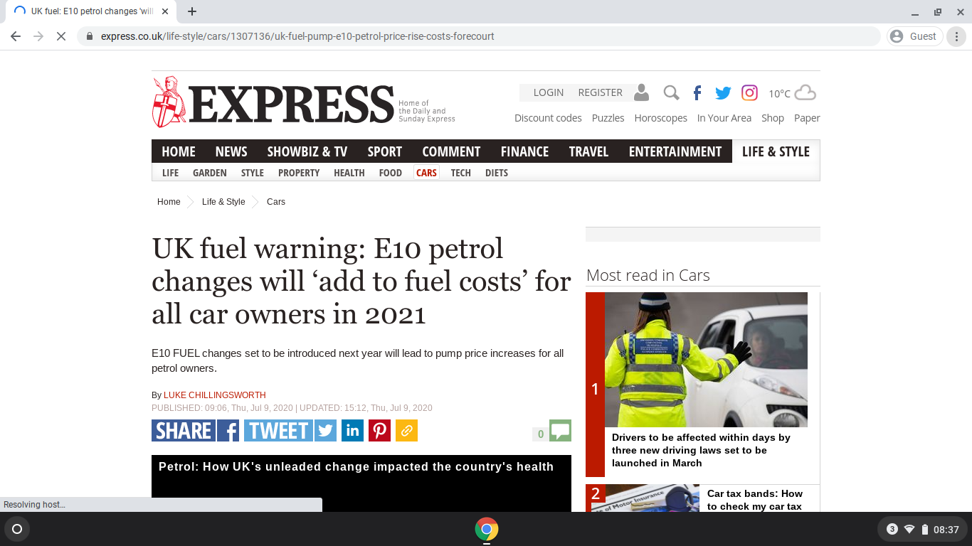

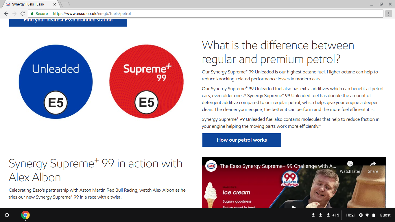

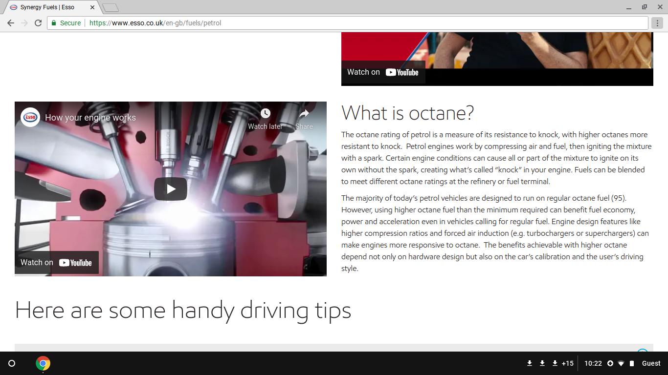

@e-RoottootIf you can find a publication that says it’s going to be cheaper, then please share it. I don’t believe for one minute it will be cheaper here. Any excuse is used to raise prices.
As expected.  The Express.
  The UK will be grinding to a halt in May due to snow chaos as well...
