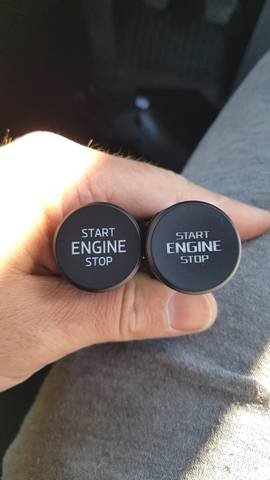

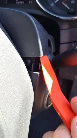

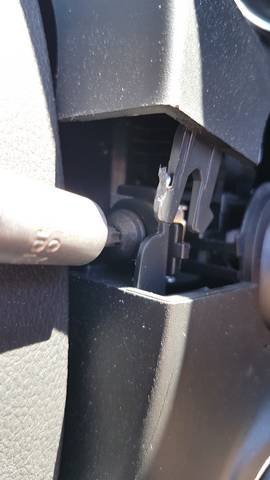

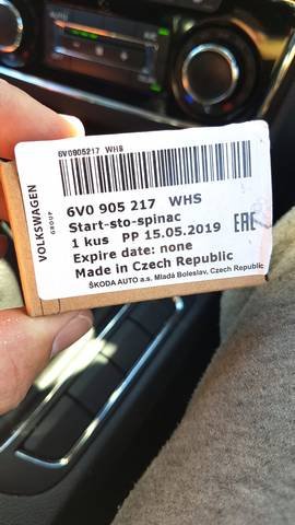

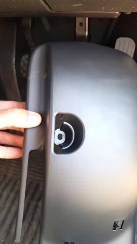

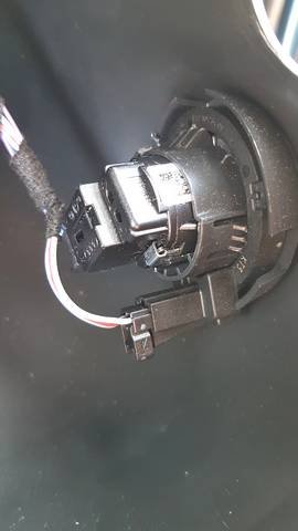

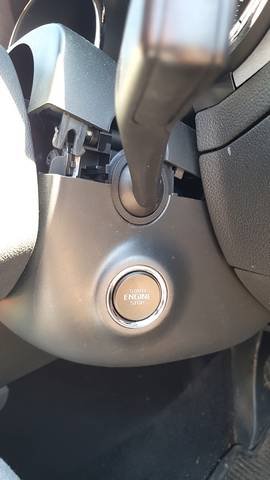

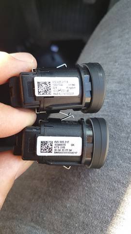

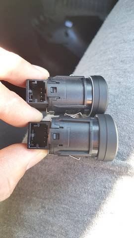

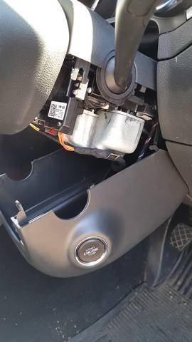

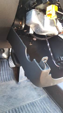

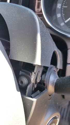

  1. Hi, No problem, glad the pics were of use. Sounds like the same issue as mine, progressively less responsive button and you almost have to develop a 'knack' of how to press it. I didn't want to get stuck so decided to change it. I bought my new switch from my local Skoda dealer, around £40 UKP I saw other sources online but with the change in part number I figured if they supply me the wrong part I can easily take it back. However I can confirm the button is working fine based on the part number in the photos. I had an issue just yesterday with the key fob not being recognised however it turned out to be a virtually flat battery in the fob which was easily changed....something I would maybe recommend doing annually. Best bet would be to go to a Skoda / VAG dealership and ask them to source the button for you. Hope you get sorted out....
  2. Thanks for the information, did you buy the parts from a dealer ? Did it take long to change out, I assume it is a pig of a job lol....!

  12. My car was in at the local dealer for a service and they commented the Start Stop button was sticking. I had noticed it was needing a bit more of a positive push but not had any bother so far starting or stopping, got the knack of working it I guess... Is this an easy DIY replacement job ? I have been quoted £124 incl VAT for replacement, the switch is around £40 apparently (part number 3V0905217AWHS ?) I read on here that electrical contact cleaner is a good option to try, any thoughts ? Certainly don't want to be caught out for the sake of a switch...! Thanks

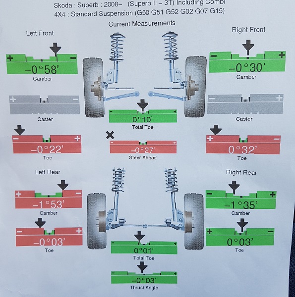

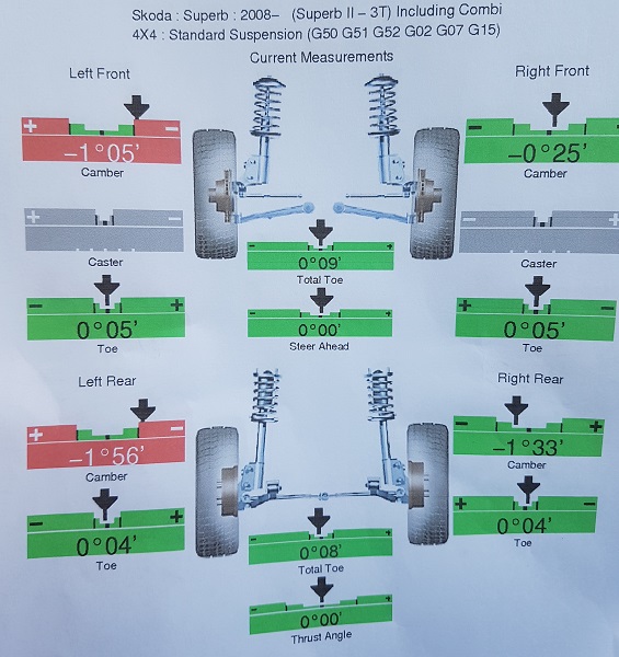

  13. Seeking some advice on toe and camber settings following a 4 wheel alignment done this morning.... After getting a full set of new tyres I booked in for a 4 wheel alignment locally. The rear passenger side tyre was badly worn on the inside so things were clearly out of adjustment, seems to be a common Superb Estate issue.... The garage was using a Hunter system and gave before and after prints as attached. Anyway, I am not convinced on the new settings and questioned these at the time, but was told 'its a 4 wheel alignment and we only ever adjust the toe, and not the camber as its not adjustable...?!' I got a second opinion elsewhere (Kwik Fit of all places....) and was advised everything should be 'green' suggesting camber is adustable. I questioned the original garage again but was pretty much told they only advertise 'alignment' and not camber.... Am I wrong to expect the camber to be part of the deal on a 4 wheel alignment ? Left Front and Rear camber appear out of tolerance, and worse than before alignment...should I be getting this re-done ....? Thanks Before After
