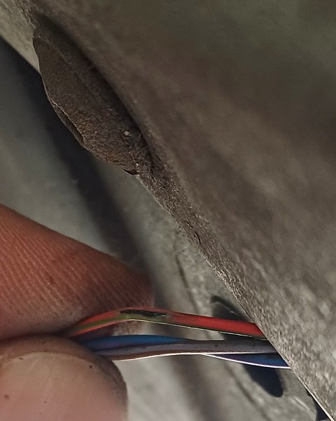

2014 Estate Rear Parking Sensor Wiring Loom
I've had a fault with the right rear parking sensor for a while and finally investigated assuming it was a dodgy sensor or corroded connector but it turns out to be a one of the wires has been nicked or rubbed through... I'm thinking about cutting out this bad section and soldering fresh ends together, with a short piece of wire if needed to make up the length...I assume that should work pending no other breaks in the wire ? Failing that, does anyone know the part number for the loom ? I've had a search of the forum but couldn't find any previous reference. Thanks Dave
