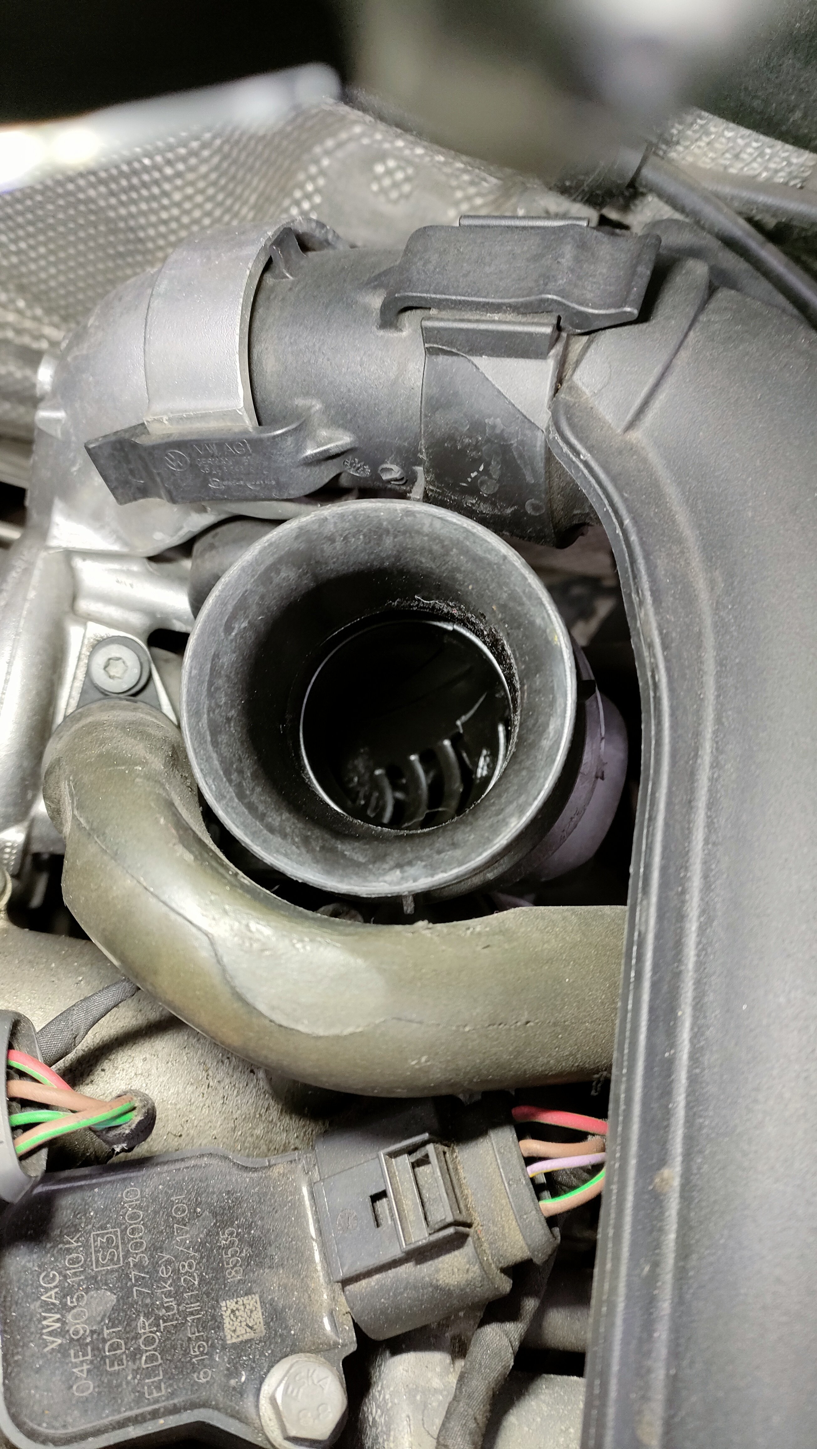

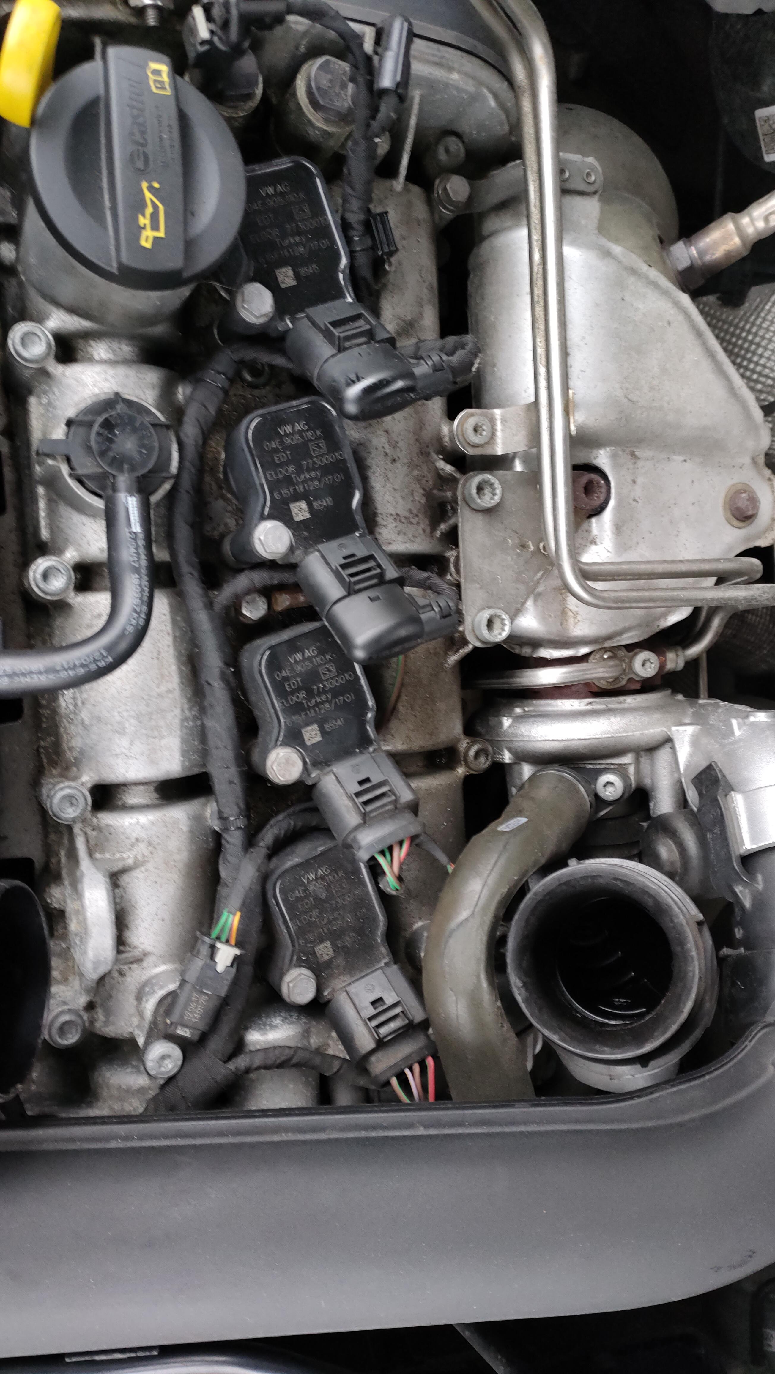

I appreciate all the suggestions guys. I can definitely try what xman said. By the way guys, is it normal to see mist of oil in air inlet. Please see the pictures.

It's not only flashing engine sign. Stop/start doesn't work as soon as engine sign flashes. The next day car starts normal and runs normal which means start/stop works fine until engine gets enough hot. then without fail it throws the engine flashing sign on the dash, consequently stop/start gives error . Its happening eryday. Mechanic checked the live data and based on that they said three cylinders misfires. I know it could be anything..but how to pin point the fault. I like your idea though to swap the coils. but as i never changed the ignition coil i rather not touch it. I may pay some money to local guy to swap it for me. do you think i should do it? so far only cylinder 4 hasn't got any problem..and cylinder 3 is almost every occasion. N.B: One thing I definitely want to make sure that there was not a slightly loss of power. if there was any problem with the cylinder I should be expecting some lacking of power, isn't it? OP said he/she changed all the coils and spark plugs and also his/her symptom was losing the power. Is there any update from you randompunter?

I got your point but volkswagen specialist did diagnose with their tool and they identified cyl 1,2 and 3 has the problem and as far as i can remember when this problem occured for the first time..it was also 1,2 and 3. Another thing is i dont know not know how to change the coils or plugs..

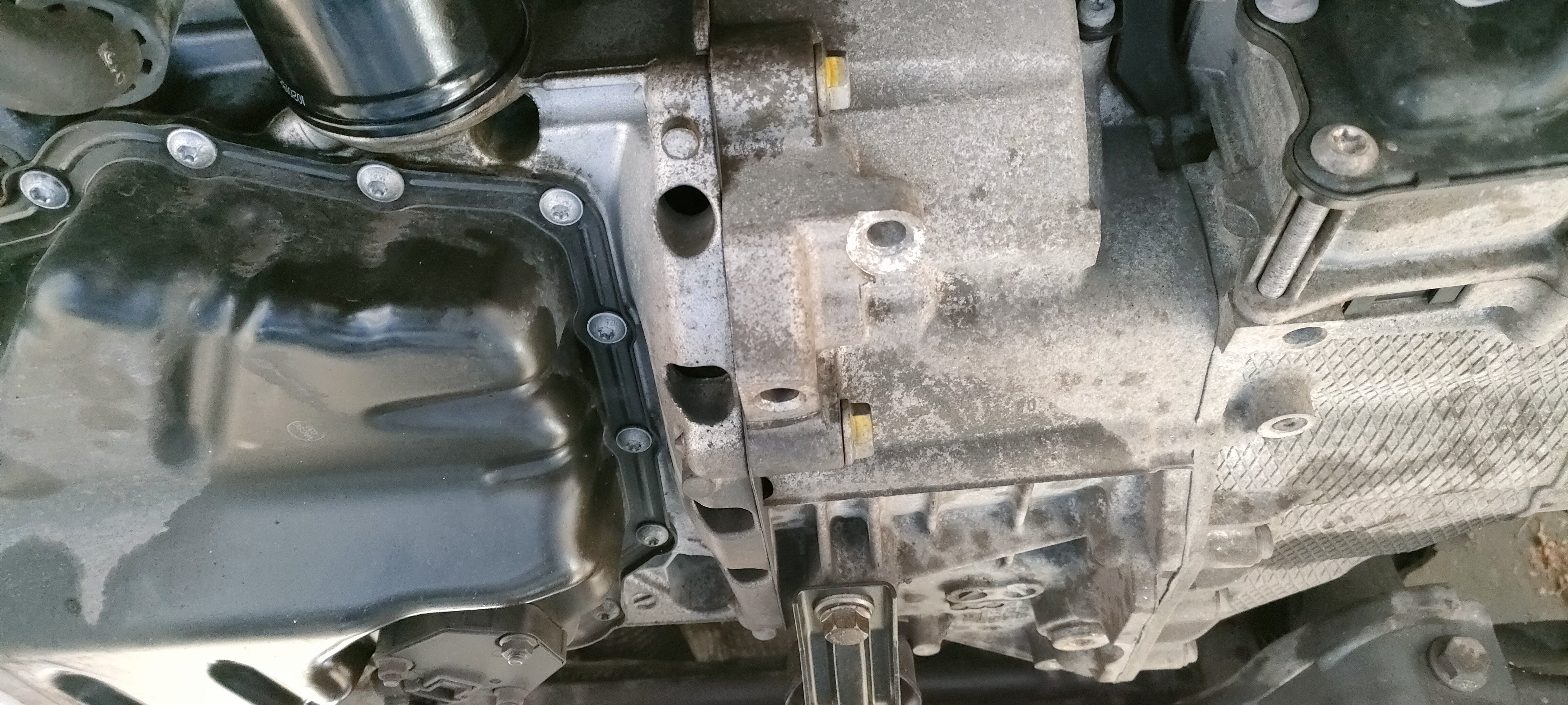

I did the video of underneath, though it wasn't good but still it can give you little bit of idea about the oil mess.

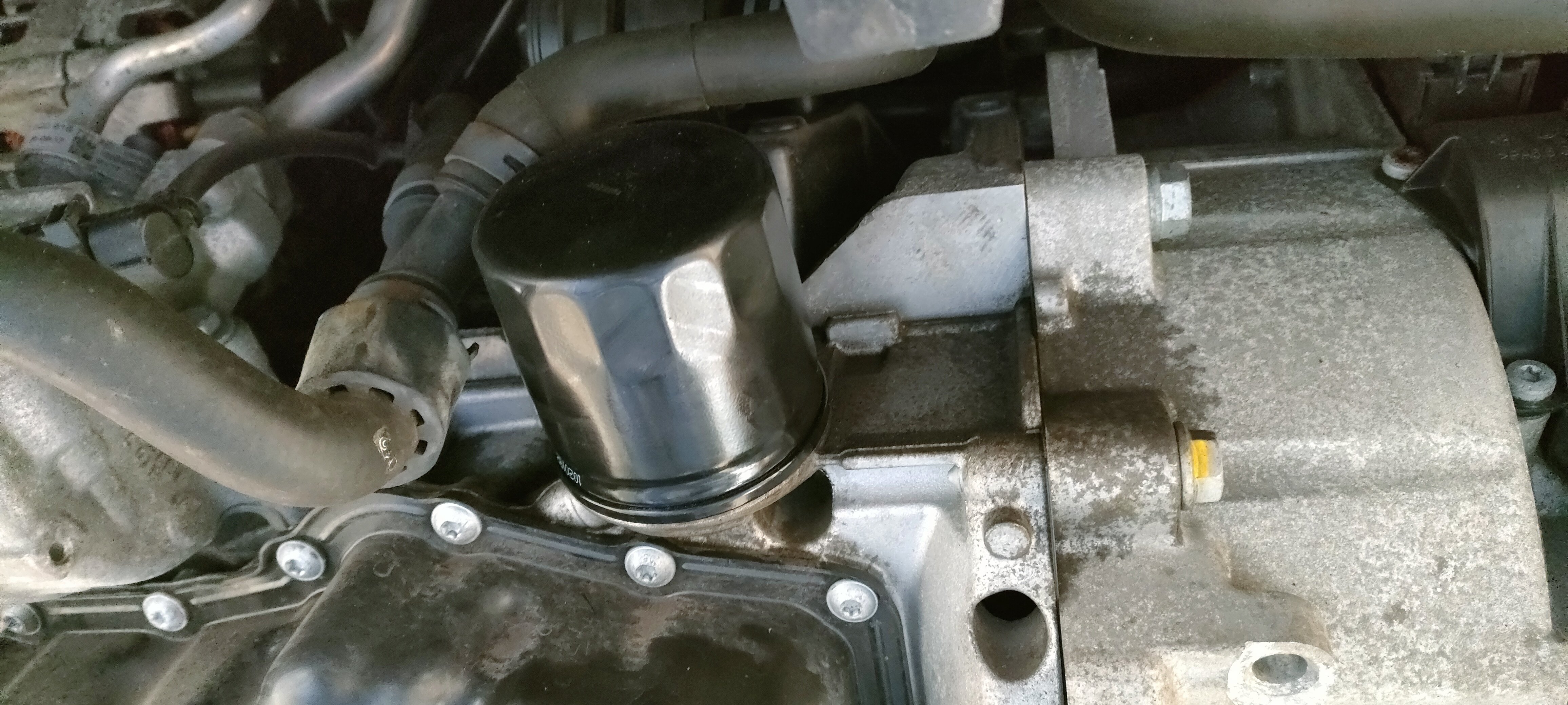

Yes. It has. I took it off just to see oil filter and so. Can oil sensor make the oil drained! There was no oil left in the pan when i checked with dipstick. I have seen oil all over underneath of the car. There is circular shape something in the middle..it has got oil as well.

Do you think so! But he failed to show me the old sump and he was even mumbling. What i think is .it was only oil filter which was damaged..i saw it myself that it was bent. No oil i saw in the Oil sump.

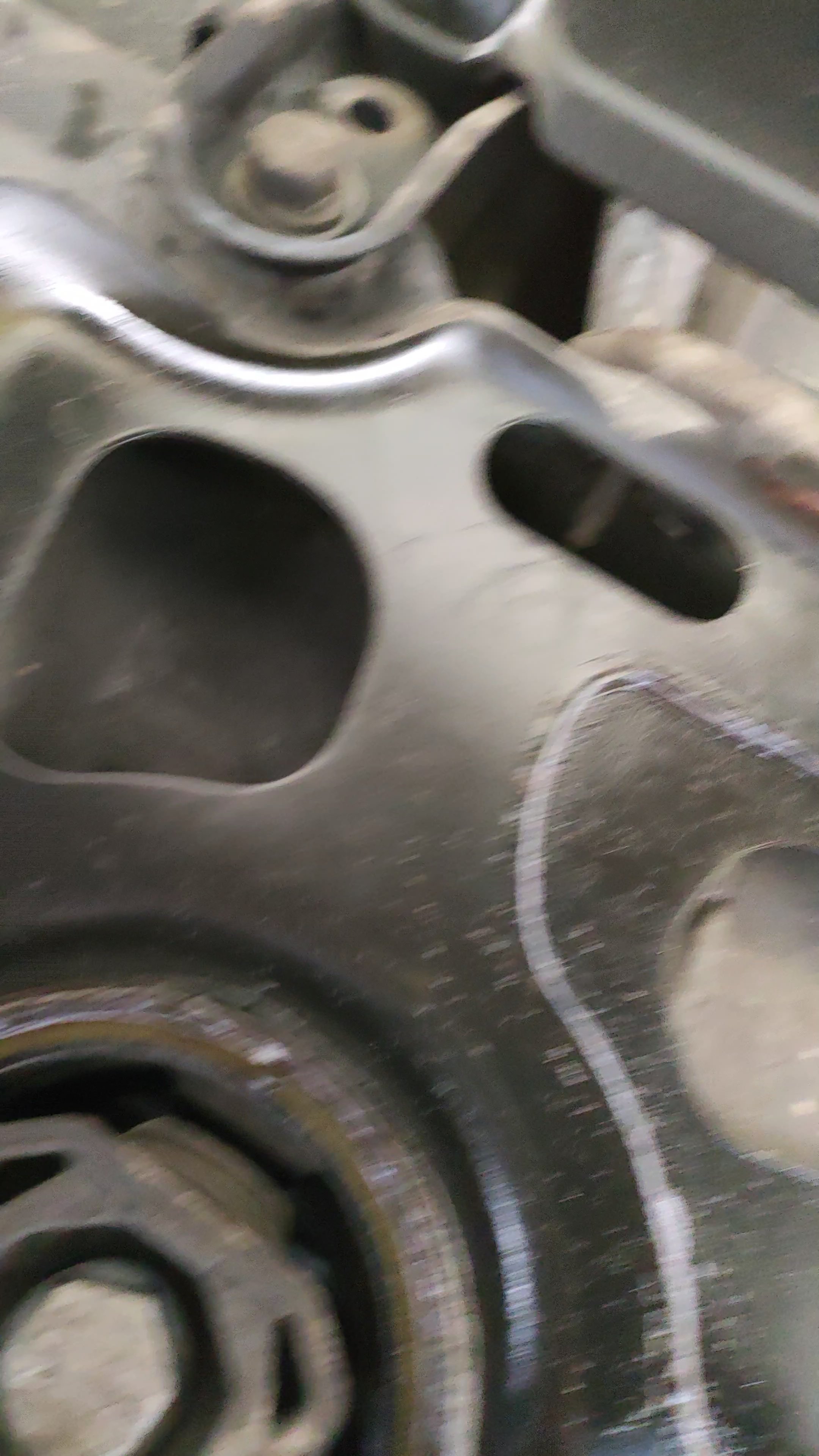

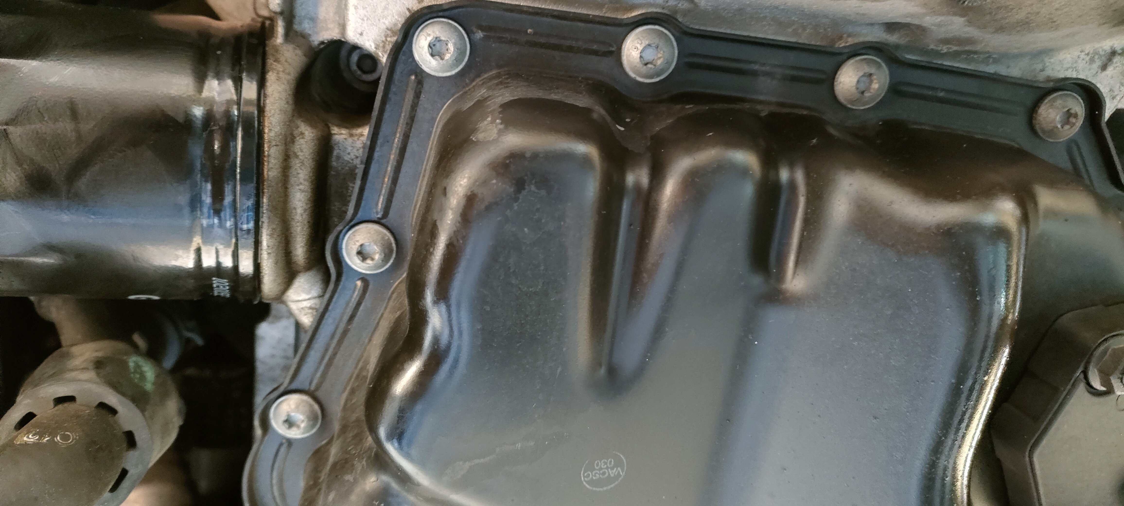

I like your idea and advice cheezemonkhai. I will buy a bottle jack tomorrow and if weather permits I'll go under the car to see and probably will take some photos to share with you. When that guy put the car on the ramp I went under the car but didnt see any damage except the oil filter. He said top part of the Oil Sump got crack because of the impact. But to be honest, It was just little hit on the bump. I wasn't driving fast..just slowly driving over the bump while press holding the foot brake, underneath of the car touched the bump. I heard a noise. It happens to many car, especially with my friend who has MB E-class. I got a feeling that he probably just changed the Oil filter only and that is what was damaged.

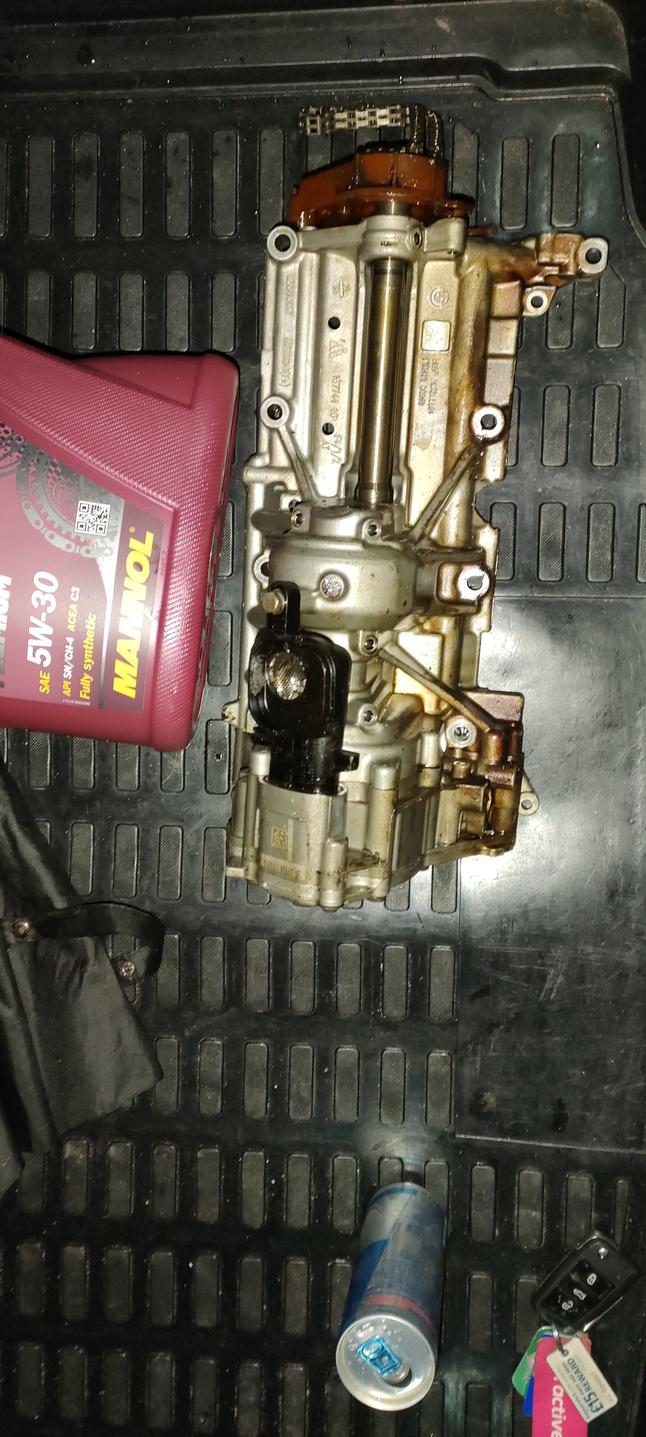

Yea, it's BMW logo and it's bmw part. I am fuming, why did he cheat with me!!! I will probably go to him tomorrow morning. Thats the oil as well.

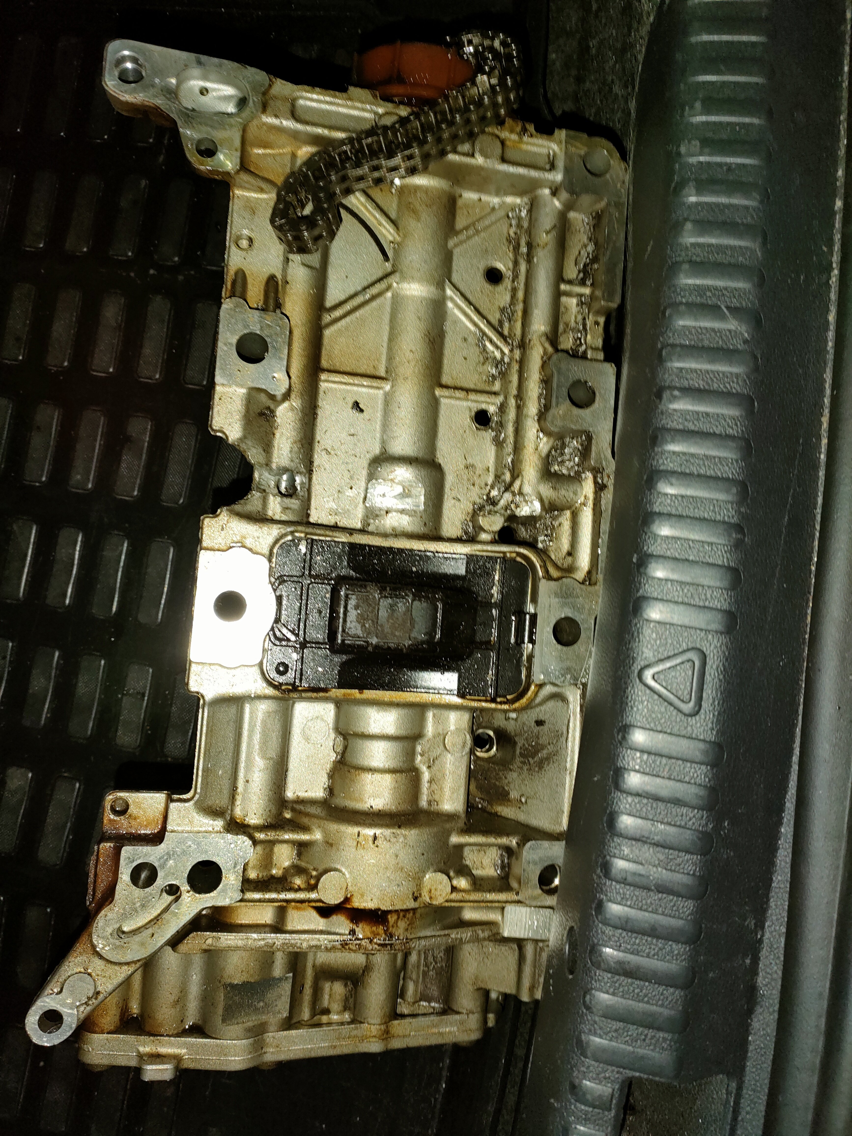

Perfectly right. It is BMW part and it has got BMW logo in it . I just got back home right now and inspected the part. I will never know what was wrong with my Oil tank but he somehow managed to fix it as it appeared to me. I said earlier, I don't trust this guy but i had no other choice other than him as he is local garage.

I got the car fixed. As i asked him to show me the damaged part, he gave me this part (pics). He also left the leftover oil in the car. I can see that he used 5w-30 oil indeed..but getting confused about the part..is it the right part?

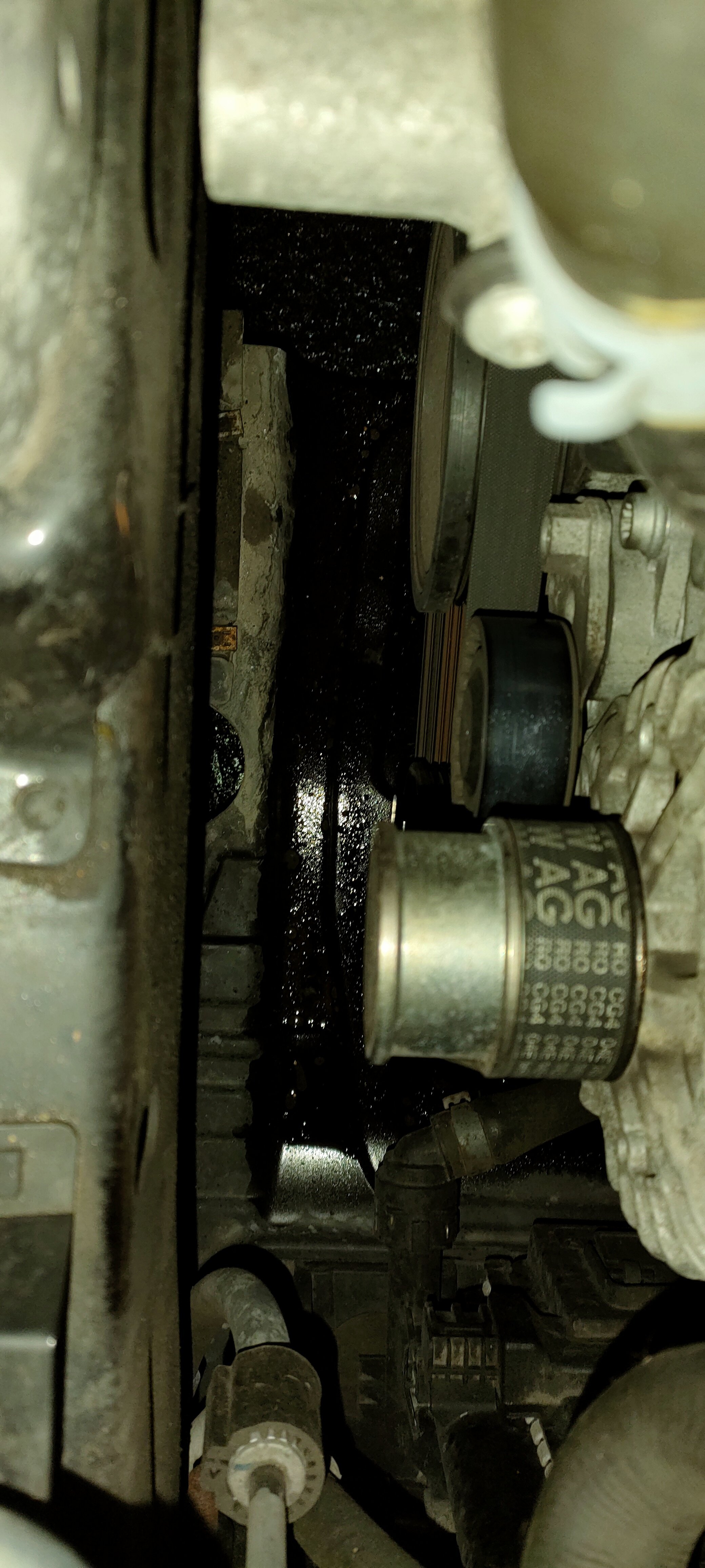

Guys, Bad day again...as I was driving this evening, engine light popped in saying low in engine oil. After driving around couple of miles in the city (20mph) I stopped the car and inspected, Oh my days, Oil all over on the under cover, bottom of the engine and timing belt. I checked with the dipstick and there was no trace of oil at all in the tank. I now remember, last night I hit a hump..it wasn't that hard hit which is why I didnt care..but now I am thinking it could be because of that I messed something in the Oil. Can somebody give me any idea, what could be the potential damage (as i hit the hump) and how much I am looking to get it fixed.. Oh God freezing cold..waiting for recovery lorry to come and take me home.
