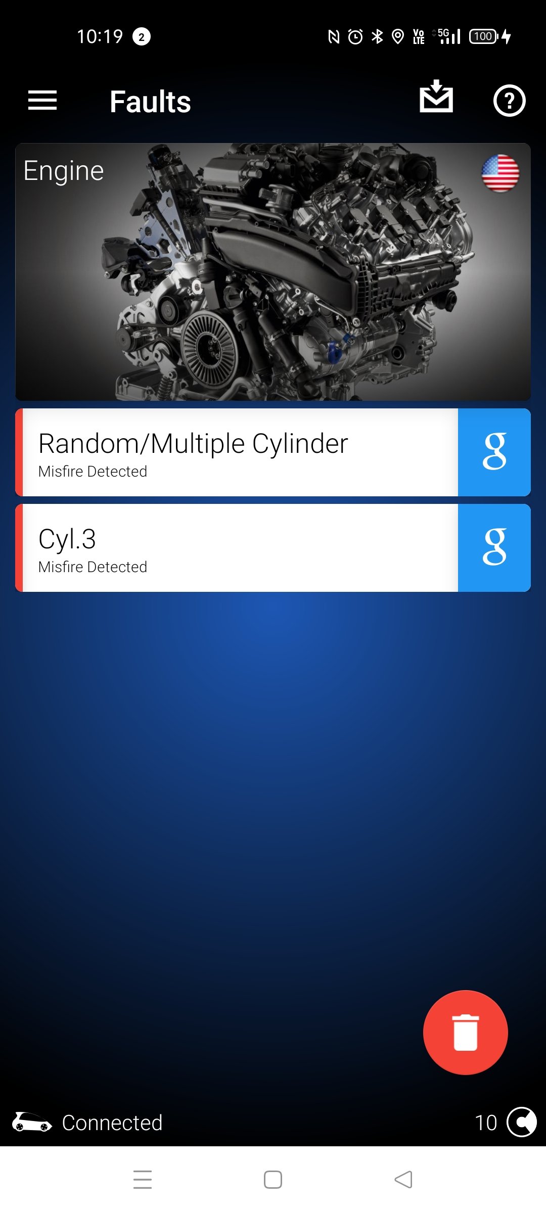

Is there anything else I can do by myself? neither i have tool nor i am competent to do compresson test. garage will charge me £80 just to do compresson test, I already paid £70 just to run the diagnose the problem where they said coils and plugs need replacing.

Hi Guys, i have a 1.4tsi hatchback 2017 150psi Skoda Octavia SE L. Recently I am having some problems with the start/stop function of the car. Car starts working normal but after few hours I can see that Start/stop doesn't work. when i press the start/stop button to check it says start/stop error. I ran the diagnostic by OBD11 and it pulls up some errors which shows that Cyld3 misfire. Trouble codes: P030000 - Random/Multiple Cylinder Misfire Detected static Date: 2022-02-07 20:11:08 Mileage: 97895 km Priority: 2 Malfunction frequency counter: 1 Unlearning counter: 255 Engine speed: 703.00 1/min Normed load value: 14.1 % Vehicle speed: 0 km/h Coolant temperature: 94 °C Intake air temperature: 41 °C Ambient air pressure: 1020 mbar Voltage terminal 30: 13.004 V Dynamic environmental data: 20965011BE000E13F481CDF40681F4463410D3000414B40E10 P030300 - Cyl.3 Misfire Detected static Date: 2022-02-07 20:11:08 Mileage: 97895 km Priority: 2 Malfunction frequency counter: 1 Unlearning counter: 255 Engine speed: 703.00 1/min Normed load value: 14.1 % Vehicle speed: 0 km/h Coolant temperature: 94 °C Intake air temperature: 41 °C Ambient air pressure: 1020 mbar Voltage terminal 30: 13.004 V Dynamic environmental data: 209650F44634F40B1D1010008B14B40E101199100017460001432100 I had the same problem since few weeks. I had the Ignition coil packs (Starline) and spark plugs (Bosch) replaced thinking that it could be because of faulty any of them. but nothing helps to cure the problem. Does anybody has any idea or similar symptom in their car? Please note that, I don't have any power loss in the car while accelerating.

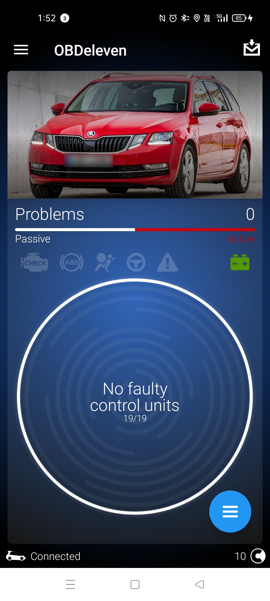

Hi, I have been scanning almost every day but no problem were detected at all. It seems ignition coils were faulty in my case. N.B: I'll keep scanning and in case problem reoccur, I'll update the post here.

I have had my Ignition coils and spark plugs changed. drove the car for 4 hours afterwards and diagnosed with OBD11, but no problem in any of the cylinders were detected (as of yet). fingers crossed for the upcoming days. My original coils and spark plugs didn't look bad though. if they were faulty would they not be broken or damaged physically, just wondering?
