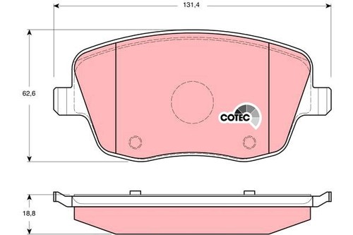

On the Fabia MK1 VRS, fitting bigger front brake discs than the standard 288x25mm will mean that 15" wheels will no longer fit.
Considering that the Fabia MK1 VRS uses small outside diameter tyres such as 195/50R15, going up to 16" and beyond will result in a noticeably harder ride and more prone to pothole damage compared to 15" tyres as the height of the sidewalls become very low once the wheel size exceeds 15". I would probably choose 185/55R15 because it matches the outside diameter of 195/45R16, so won't increase the standard gearing. On the Fabia MK1, you could use 185/55R15 on 5.5Jx15 ET34 rims. 185/55R15 is a size that's used on the much later Citigo/Up/Mii, and on these cars the 185/55R15 tyre size is also fitted to a 5.5J rim.
Even the Fabia MK2 180HP VRS only has 288x25mm front brake discs, so you are in good company.
If the brakes don't feel powerful, they may simply be worn out or someone has fitted cheap parts, with a common culprit being cheap brake pads.
The front brakes on the Fabia MK1 VRS are a TRW system, so it makes sense to use TRW brake pads...as shown in the links below.
TRW GDB1414 front brake pads (for Fabia MK1 VRS)
Brake Pads Set GDB1414 TRW SK6Q0698151A 6Q0698151A 23581 Top Quality Guaranteed - Picture 2 of 3
https://www.autodoc.co.uk/trw/2192029?search=TRW Brake pad set (GDB1414)
https://www.ebay.co.uk/itm/334815641540
