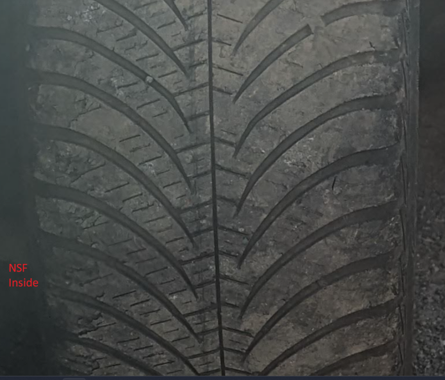

Tyre wear (possibly indicating under-inflation), but at OEM spec
I cannot say that I dont enthusiastically drive... that was another consideration too! I'm also aware that being all season tyres they are softer when its warmer (like... now!) 36psi (2.5 bar) is above both OEM recommendations for < 3 people, hence why i'm a bit confused why I appear to have "underinflation" type wear, but if that wear can also be explained by enthusiastic driving, then that's probably it! I'm certain they're still legal, but will get two ordered asap as never like to be right at the limit. If anyone is looking for all seasons, these have done 35k, have never let me down in grip in the dry, wet or snow (although they feel strange in corners esp when new, you get used to it).
Washing the car, with wheels turned full lock, and noticed the tyres looked a bit odd. I check the tread depth regularly, but have obviously ignored anything more in depth (I should be shot for this!). They are Goodyear Vector 4Seasons, so all season tyres, put on in 2019, so have now done approx 35k miles. Anyhoo, across the central 3/4 I have > 1.6mm (although it's pushing it at the edges, down to ~2mm at the 3/4 edge, so I will be looking for some new tyres asap), but the edges look more worn than the center (and measures too, center depth is 3.5mm~). The edges that would be facing the N/S seem especially bad. Nothing was mentioned at the previous service or MOT 10 months or so ago. Tyre wear pictures online show that it might be a mix of alignment, and also underinflation, but that IS something I keep on top of checking, and generally run at 36psi front and rear, since i'm not the smallest of people, and the boot generally has a fair bit of stuff in it (but nowhere near 3 passengers weights worth in the back). The rears seem even and are only at 5.8mm or so. Aside from a 4 wheel alignment (which is planned after the new tyres), is this wear pretty standard of an Octavia? Or is something more suspicious going on... handling seems as fine as it is on all seasons in 25+ degrees C weather! The fat twi looking thing top right of the nsf picture is the snow limit, the legal twi is 5 treads below it

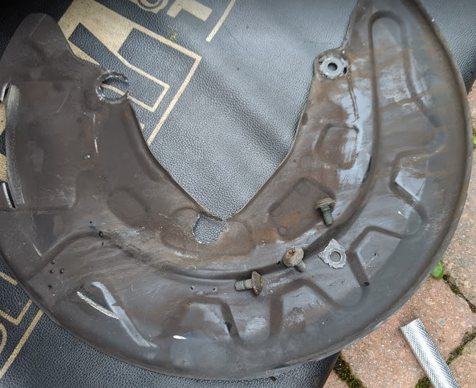

Octavia "throws" a brake disc shield.
The weight, and the fact they're not magnetic in the slightest leads me to believe that - and the corrosion is white and powdery in nature, not rust. The weight id liken to that of a foil dish you'd make a flan in.
There is a mix of front and rears on this thread. If my theory is correct, if the screws haven't been tightened so hard as to damage the paint where the screw heads/mounting face sits, then they should last fine. If your plates are in good nick, I wouldn't touch em personally. I'm not replacing any more of mine (and important to note that the one that failed had likely been removed/reinstalled at some point in my car's life before I had it according to service documents).
Same happened with my Octy, but a front one. The shields are aluminium, the screws are steel (but plated). Put aluminium and steel together and you get galvanic corrosion occur. My shields on my previous car (steel, they looked rusty but still solid) lasted a full 10 years and were never touched. My theory is, as the screws are tightened, the paint may be disrupted on the shield and then allows this to occur. I put a smear of grease under the screw heads (I toyed with the idea of a fibre/rubber washer), and the mating faces on the back, just as an experiment. Mine was 4 1/2 years old when it failed... To replace the front you need to remove the caliper, caliper bracket and brake disc.
