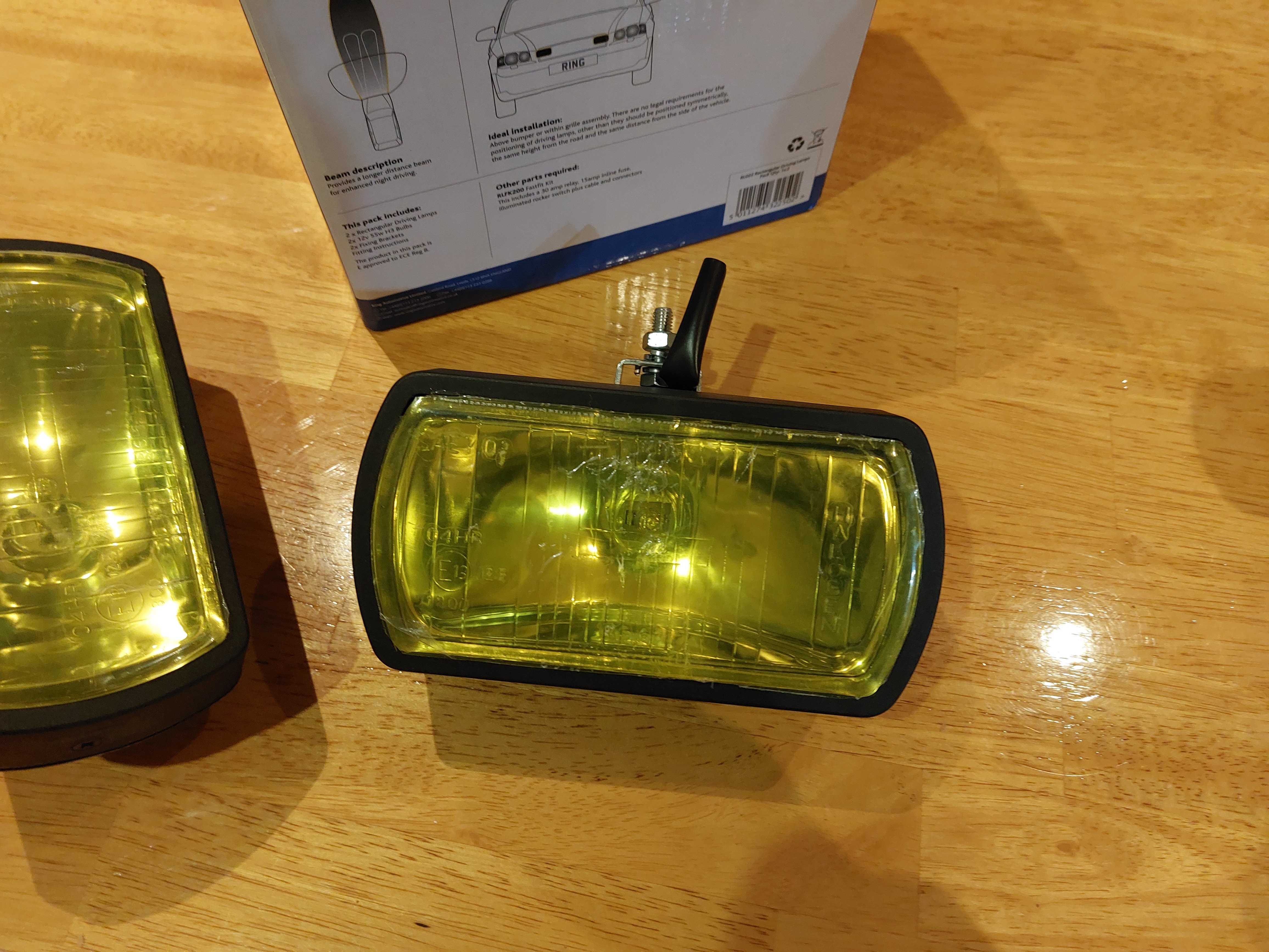

Ha! They're Ring lamps I got of marketplace for 20 euro. Funny the ring spotlamps I put on the Monte recently came with covers, but these didn't.

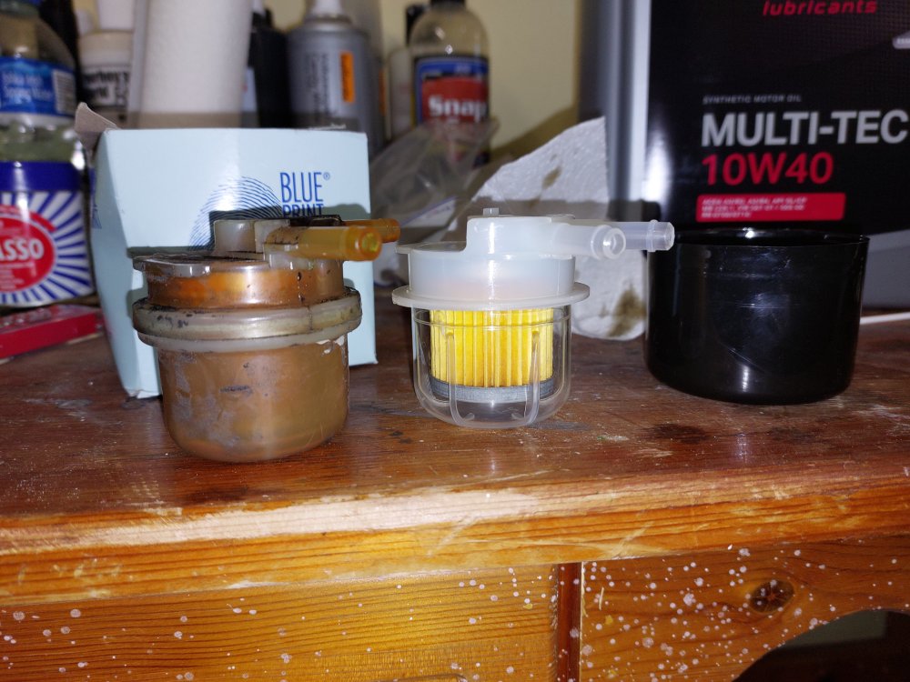

What Knob said that? Most of that is probably coming from it being run with low fuel (and old fuel) for a bit. Should be about 20l of fresh fuel in it now. Have been chucking Redex down it too to try clear things out. Points are connected as the old ones were, did take photos to help remember what wire goes where. That filter is literally weeks old but considering how cheap they are I think I'll just keep changing them until that ****e is cleared out of the tank. One more thing, forgot to include pictures of the new lights in a previous post. Initial plan was to hide them behind the covers when I didn't need them, but these are far too big for that. My bad for taking a chance on ones on marketplace. Probably still going to use them however. I think they do look correct on this sort of car. I am a sucker for yellow lamps on any car however. Anyone have any opinions on these lights?

Update time: Had this thing idling away in the garage and it just died on me and wouldn't restart. No spark. Day after that I got my big load of parts so saw to putting them on. New HT Leads Points Did take the distributor off to fit them because the screws holding the Points in were ready to strip. Marked it so timing should be relatively close to before. Checked the fuel filter I put in a few weeks ago, definitely doing its job, have yet another one I'll replace it with soon. Still no spark, however I have it narrowed down to the coil. Traced the positive wire to the coil and put the timing light to it. Lead up to that white box. Just to be sure I did the same to the wire coming from the other side of the box that goes onto the positive of the coil. So It's getting power to the coil, but no power comes from the big lead that goes to the distributor. Have a coil ordered, should be here Tuesday. Also still to come are: -New Cap -Rotor -Carb Rebuild kit Other things I got in that care package that I haven't mentioned are: -Timing belt -Accessory Belt -Valve Cover Gasket -Spare Plugs. One more thing to mention. Said before the backbox was solid but just the tailpipe looked crumbly I was very much wrong there. It's leaking from the gasket and on the weld where the exhaust goes into the backbox. No wonder it sounded so angry. To fit the backbox I got I'll need to have the mid section redone as it goes from 2" at the manifold down to 1.5" to the rest of the system. My backbox is a 2" one. It's a more or less straight piece of pipe from the manifold to the backbox so shouldn't be *too* expensive. Should sound quite nice and maybe even give a bit more pep when it's done.

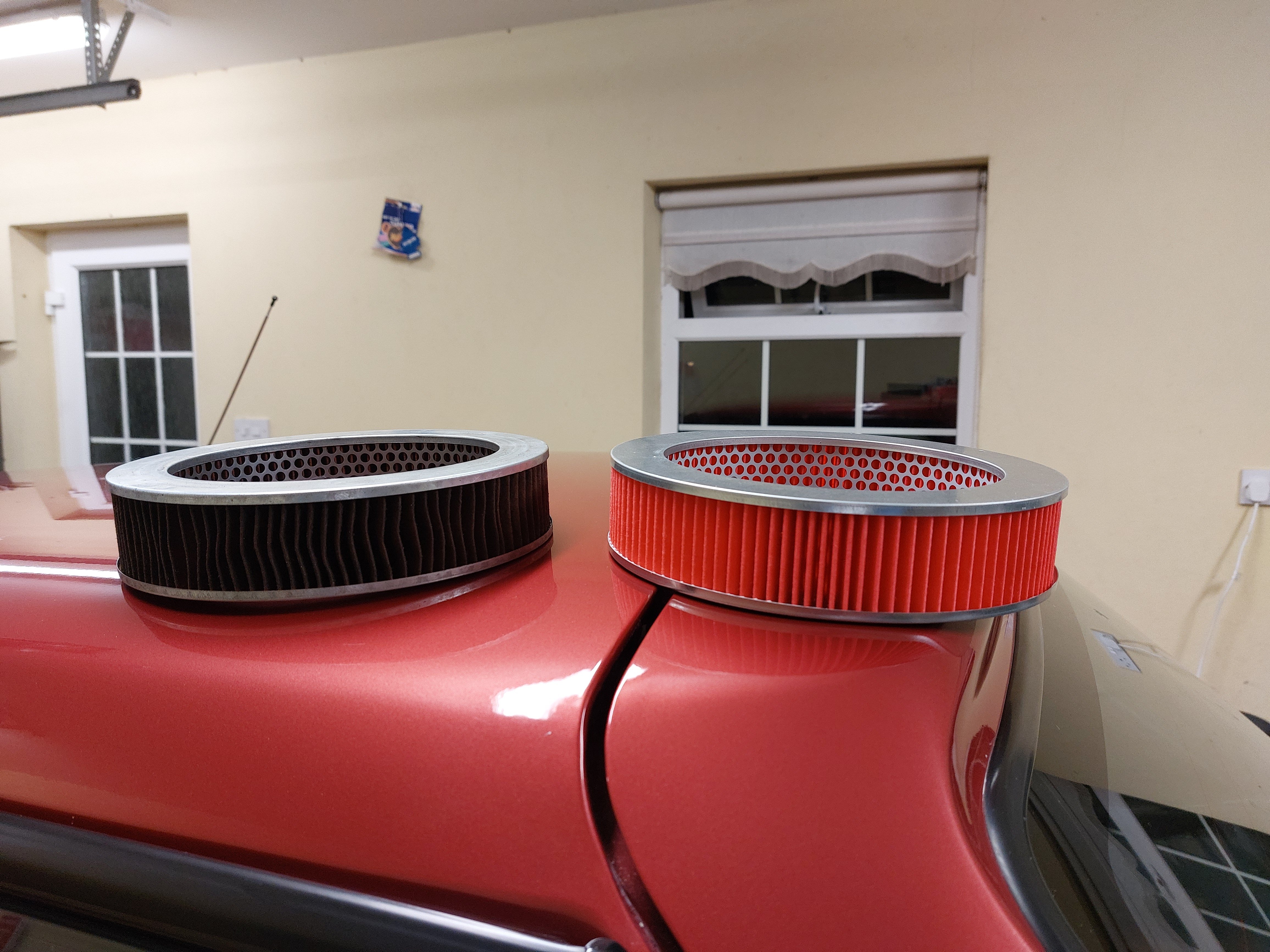

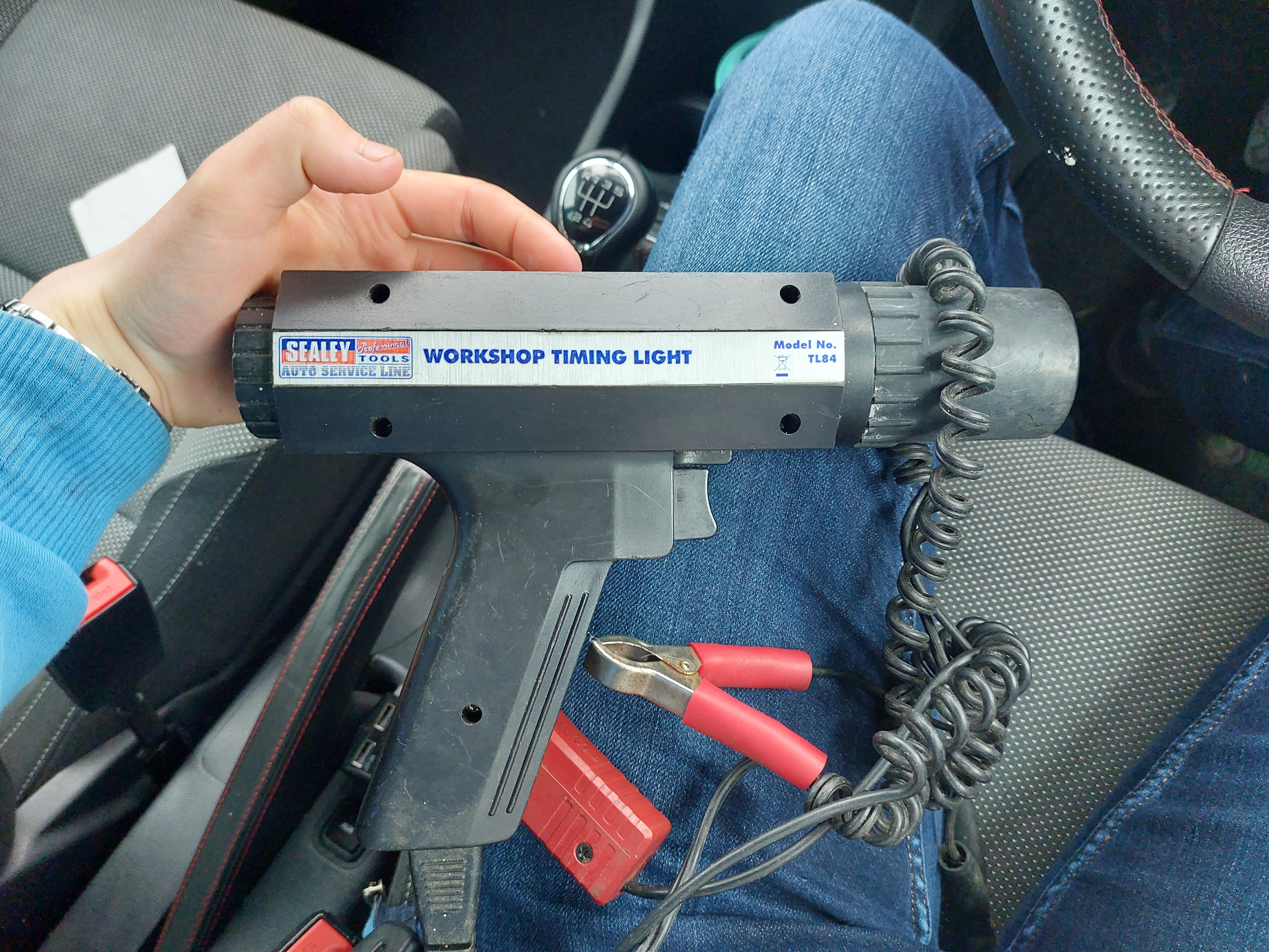

Went and got a timing light since I figure I'll need it for this at some point. New air filter put on, old one was rotten Have a big order of stuff for this coming in the next week or so. Seems to be clearing itself out a little bit more. Might have a thermostat stuck open as It takes a while to heat up while idling and the temp goes off the bottom of the gauge once you start driving and air gets through the radiator. The closer to operating temp it gets the better it runs at part throttle.

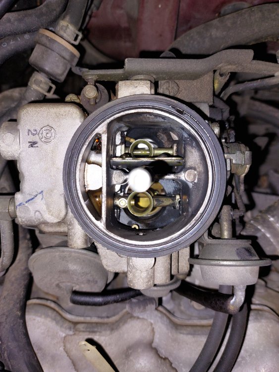

There's one of these being broken over in Ennis, might get the intake manifold off it incase I ""need"" to put a weber on. Seemingly the hitachi carb on this is a complex ******, so putting a weber in its place will simplify things a lot and (from looking at old forums) give a fair bit more power than the standard carb. Could always go really mental and put three 40mm Mikuni carbs on it, like what subaru America did to their bonneville speed record justy. That's a FWD 1l justy there, apparantly they squeezed 120hp out of it, naturally aspirated I might add.

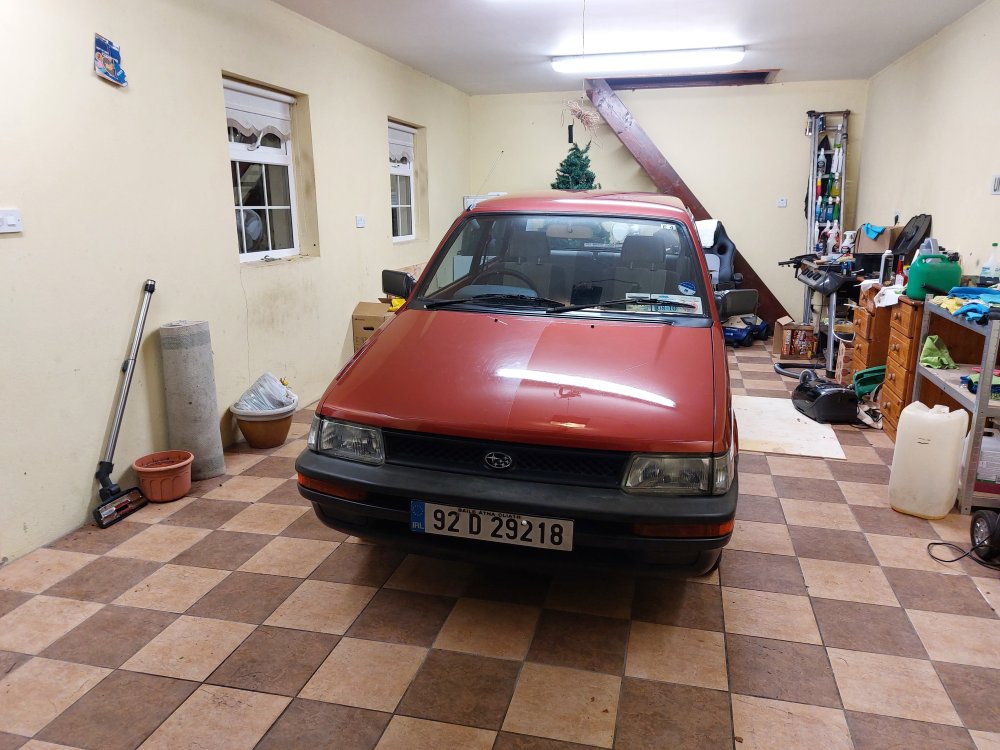

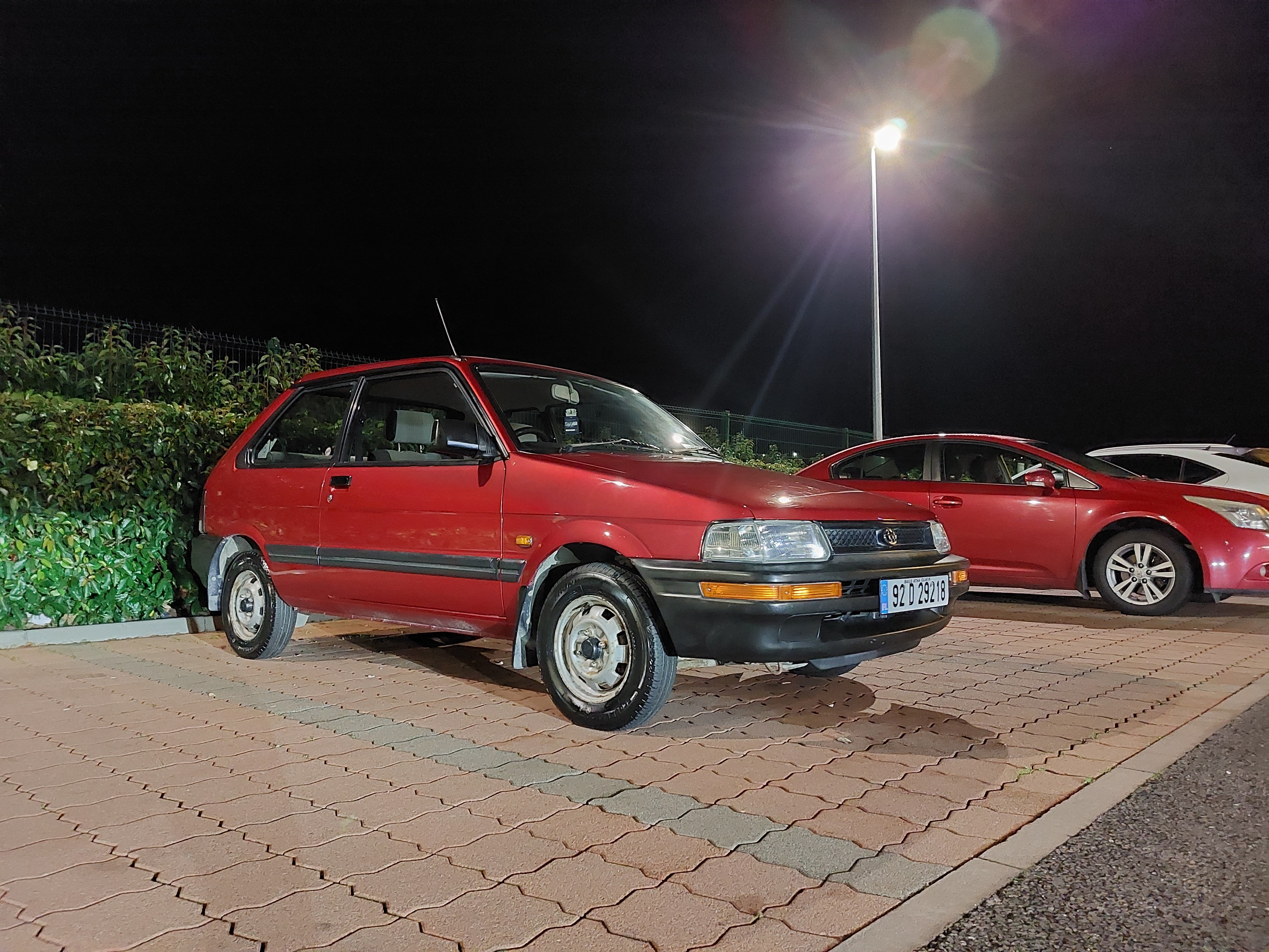

This is the more or less finished product. Its pitch black outside but hopefully I'll get some pics in the morning. Cleaned up well, thick layer of film came off the inside glass. I waxed the outside of the glass as I find it improves visibility massively in the wet. I've yet to have a problem doing it to any car I've owned. Some religious bits in the car still from the previous owner. I took them out, cleaned them and put them right back in. Didn't feel right to remove them.

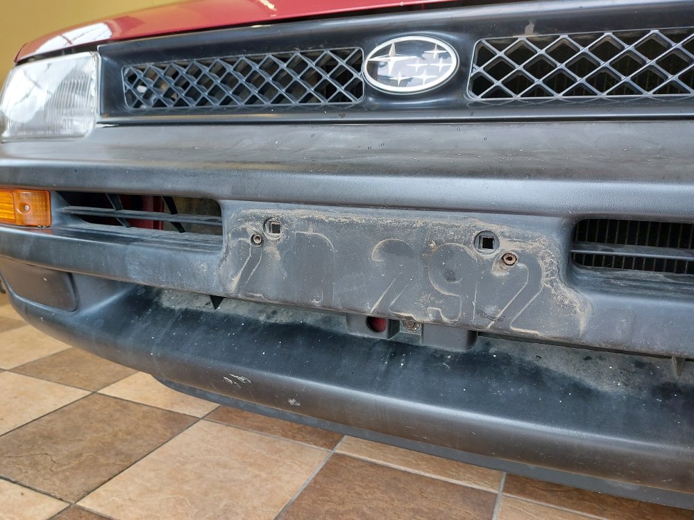

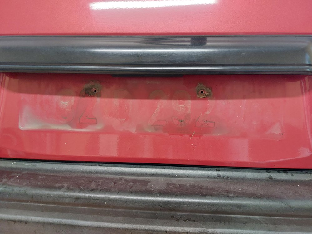

Too many photos to put in one post but I've finished polishing the paint, wasn't glazed or waxed in that photo, so might come out a bit glossier when I'm actually finished. And I used trim restore on the bumpers, Didn't get a good before/after shot like I did the bonnet, so I did one on the boot trim. Took the plates off for probably the first time, as evidenced by the imprint of the numbers behind them. Not sure whether I'll keep the old plates or maybe get new metal ones. Might put a jap/square plate on the front as it seems one might fit it better than the original one

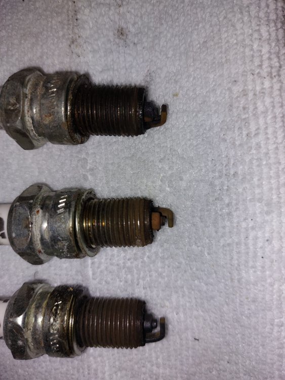

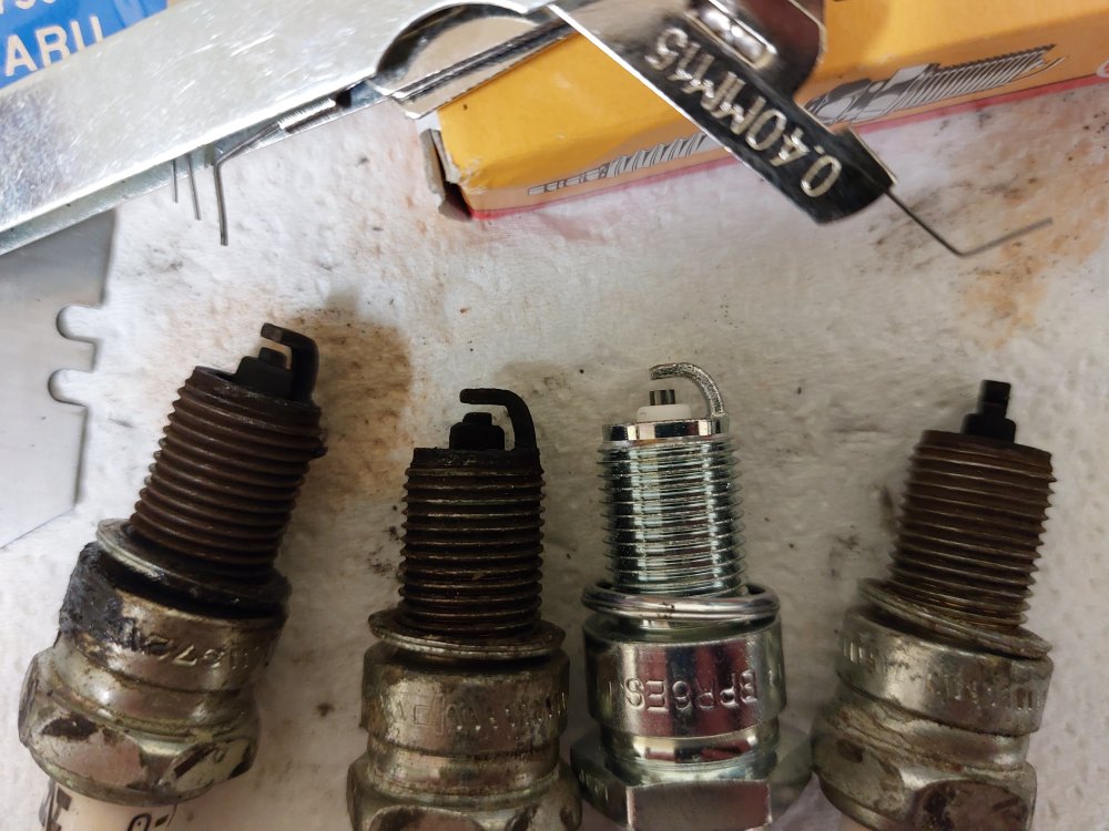

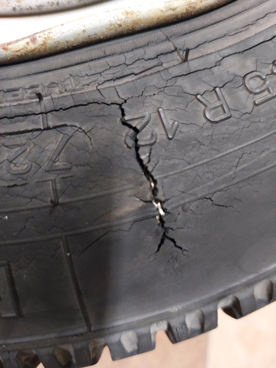

New spark plugs put in, they made a noticeable difference. Revs a lot more freely now, still a bit stumbly under 2000 rpm when you're driving it however. Clears up above that. Sounds quite nice with an open intake. Only Like this because the air filter I ordered has still not arrived. Got the wheels off it to get tyres on. Pretty good shape underneath considering. And you can see why I needed new tyres. All of them were like this And one was like this Got some ditchfinders fitted for 50 euro a corner. All the driving this will see, they should be fine.

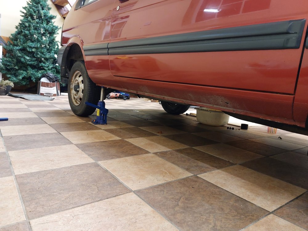

Jacked it up on one corner to get as much as I could out. Fresh fuel and New filter in Ran for a bit and looks like it's running clear fuel through the filter. Couldn't get every drop out but as much as I could. Ordered spark plugs which should be here tomorrow. Seemingly a place not too far from me does 145/12 tyres for 50 a corner. Should be OK for the driving this will see.

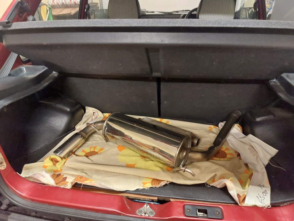

Just turned 30 too, registered 1st of October 1992. I'm really pleased to have got it especially considering it can still move under its own steam even after all this time lying up. You're right and I was completely wrong, took off the cover and it's got a rather old looking belt so it will need changing. Seemingly it's non interference atleast, and a very easy job to DIY. Anyhow, did a bit to it today, Firstly a pic of the "new" backbox I took it out and gave it it's first wash in ages, bit grimy but not bad at all With that done I took the plugs out for a look. I can't tell much from them other than they're old. Will get new ones. Gave the carb a few hits of carb cleaner, did clean off some Gunk but not all of it Dropped the fuel filter to change it New one looks slightly different but should work fine. Old filter seems to have caught some Rust from the tank. Seemingly no bung on the tank so draining the old fuel through the feed to the filter. Which will take a while. Easy access atleast, this sits high enough that I didn't need to lift the car at all to get at it. As a last thing I tried buffing half the bonnet to see how it would come up. Looks like it'll come up well.
