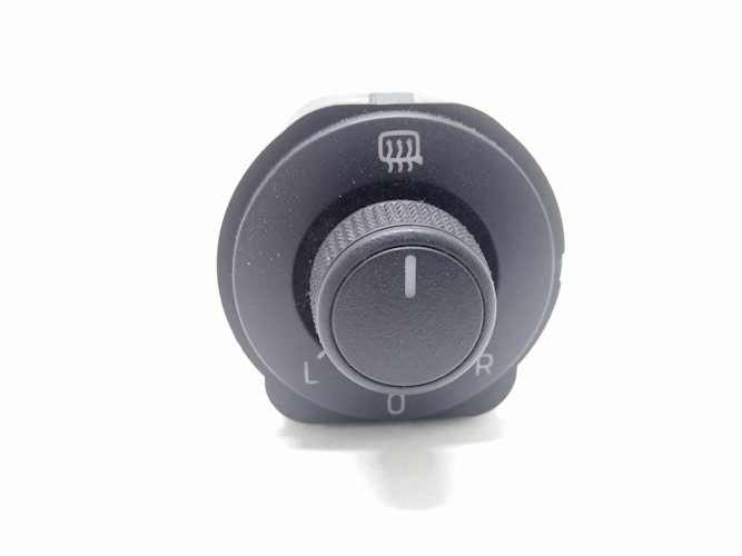

Heated mirrors?
Well, today I learned 😖 In my somewhat pathetic defence I thought that because I only ever have the 2 on at the same time and that's what my BMW did (though that didn't have a separate switch for mirror heating) 😁
Heated mirrors?
Heated rear window needs to be on and the switch needs to be in this position for the mirror heating to work.

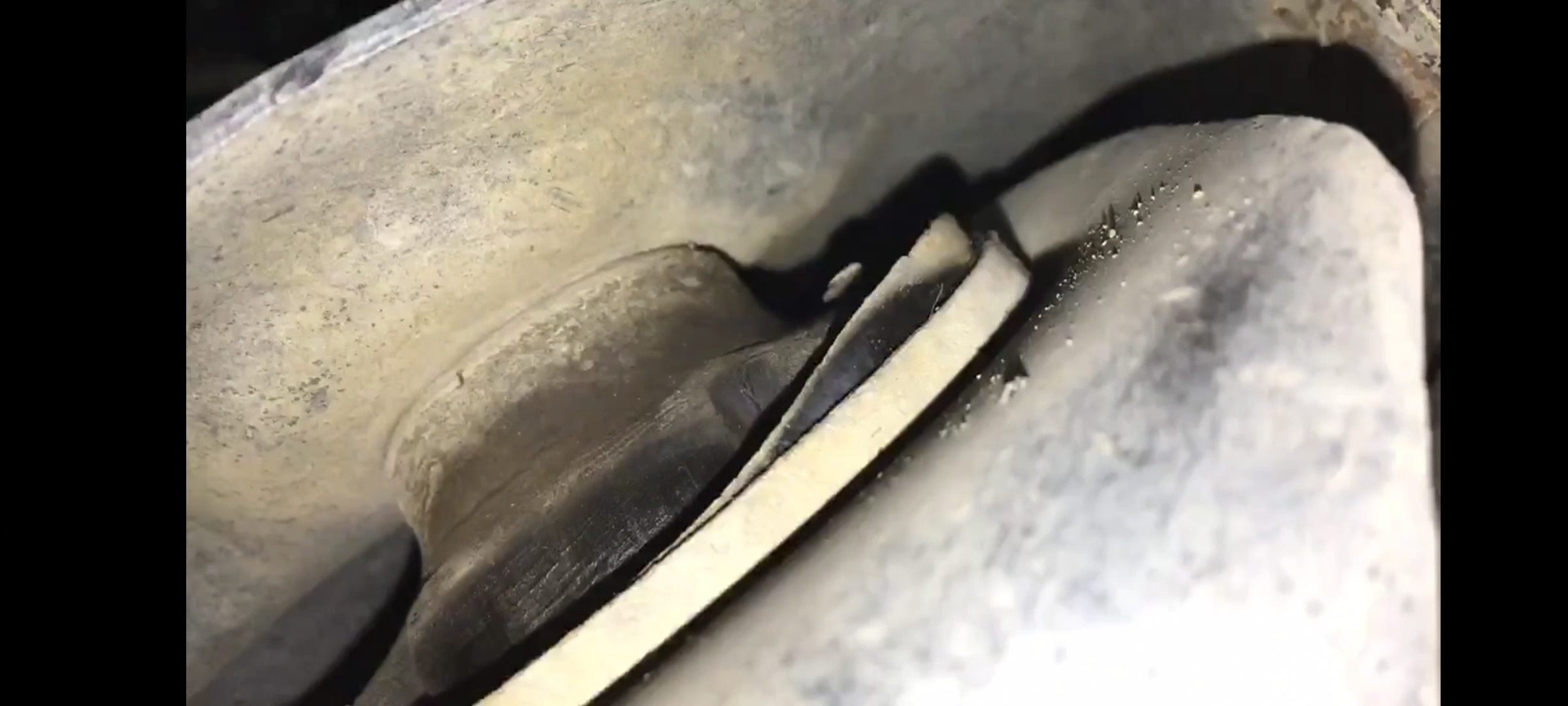

Do I need new lower control arms - with dealer video?
Next March. I stuck the car on the ramps and gave them a working with a pry bar and there was no movement so that's what I was thinking 😁
Thanks. Mine don't squeak. They've apparently "separated" and I want to know if it really is an issue or not. If it is the Skoda dealer wants £530 odd to do it but I know a decent mechanic so I'll probably get him to look at it.. I can no longer be arsed to do things like that myself.
My car was in for a minor service today. According the dealer I need two new lower control arms. They've helpfully supplied a video (link to an extract of the relevant bit below). Do I need to get them replaced or is this a bit of scaremongering? If they need replacing can the bushes be done separately. Video: https://1drv.ms/v/s!AkRfMWMlZZpfhZAgGDZFLX4LzIZItA?e=iemy2o Car is a 2019 vRS with approx 45,000 miles which seems quite low to be replacing suspension bushes. Screengrab of the clearest shot of one of the bushes:
