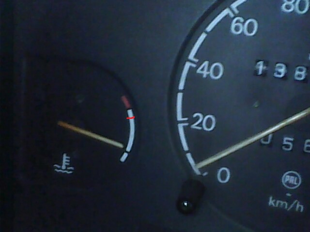

I think I will record a video later to show you how the car performs. This photo is not mine I've found it on internet but it shows just the point when the fan switches on. When driving at straights it will stay there. When climbing begins, it quickly climbs too. Strange thing is, it slows down and stays for a while at pointing straight level. That's 90º I presume. If the climb goes on, it will slowly go up. Giving the impression that it will eventually go up to the red section. I always try to keep the rev at green section with minimal gas when climbing. I'm not an aggressive driver. Instead of trying to force the car, I try to keep it to the side to let everyone pass. BEFORE the head gasket repair, one day, we hit the road. 4 people inside the car. On the highway, there are sections with slight climbing. Those are the worst. I was going with 80KM/h at 4th gear. Full throttle. I don't remember the RPM but I'm sure it was well above 2000. That was the most scary day. The temp gauge needle was nowhere near the red section but it was all time high. I marked it on the picture. Climb ended at that point and there was a slight descent this time. I accelerated up to 120Km/h easily BUT the temp didn't come down as fast as it should. My impression is, there is not enough free airflow to the radiator. Like something is blocking it. I think fan shroud is a two sided blade. While it's maximizing effectiveness of the small radiator, when there is not free airflow (dense traffic conditions in the city) it also severely cripples free airflow when the car has speed. To this time I never had any aggressive temp gauge movement in dense traffic conditions in the city. Always on slow paced steep climbs (below 40KM/h) or faster climbs (over 60Km/h) Oh, I almost forgot. The car I have has been equipped with three piece splash shields, plus a heavy sump cover over that. So there is no air coming to the sump. Some of the Favorit/Forman/Felicia cars I saw before didn't have these parts. I'm sure this effects cooling too. I'm not an experienced car owner but I think a car's cooling system should be designed to handle full throttle. I think, if I go to a long trip in a sunny summer day, this car's cooling system won't be able to keep the car at a mere 100Km/h. As you pointed out, there may be still air in the coolant. I still have hope for better cooling. I will continue to update.
