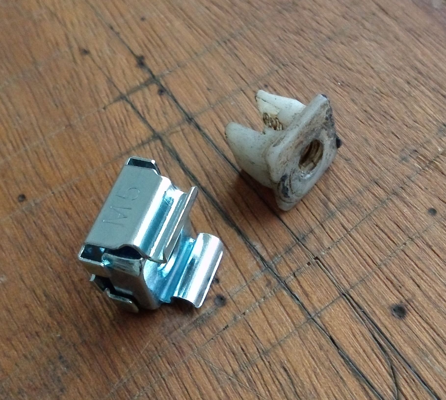

Because of the model year of your car, (1993) some of the parts in your car are %100 identical with VW of the same era. (Golf I/II/II, Polo 6N) Especially the wheels and brakes. I completely rebuilt every part connected to beam axle with parts from a VW store. Also, if you remove a screw and see it's screwed in a plastic mounting piece in a square hole, there is a high possibility you won't be able to screw into it again or it will be a loose fit. The plastic part will be split into two or it won't hold the threads of the screw you just removed from itself, forcing you to find larger screws. If you see square holes on the bodywork, use caged nuts instead of fiddling with crap plastic screw counter pieces. There are square holes with variable sizes. So I keep M4,M5 and M6 caged nuts at hand now. It saved me lots of time and headache. For example: The rear view mirror and its whole surrounding assembly is screwed in plastic pieces in square holes.
