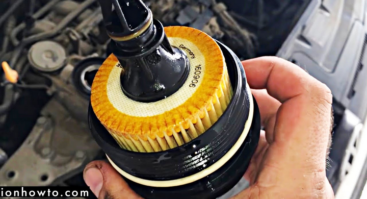

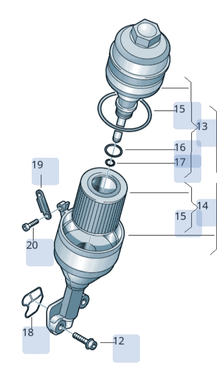

Another flashing oil light, but perhaps a bit different to the others?
No need to drain the oil. As you've said, just unscrew the cap and wait 30 secs before lifting it out. Have some paper towel underneath to stop oil dripping on the alternator and belt. A large white O ring above the threaded part sits in a channel above the threads on the outside. So three O rings in total.
They seal the supply pathway from the filter to the oil galleries that lubricate the engine, without them you'll lose pressure and flow especially at idle. Maybe been damaged/torn during filter service and/or dropped off or some numpty removed them and didn't replace them. Or maybe not sitting in the correct position on the stalk. If missing then check not gone somewhere where not supposed to. The green items in the photo
Is this engine definitely a 1.2 htp 3 cylinder? Engine code? Are the small O rings on the end of the long bit of the plastic filter housing cap still present? Items 16 and 17 Not a 1.2tsi 4 cylinder? (Thinking of the O seal left behind scenario)
