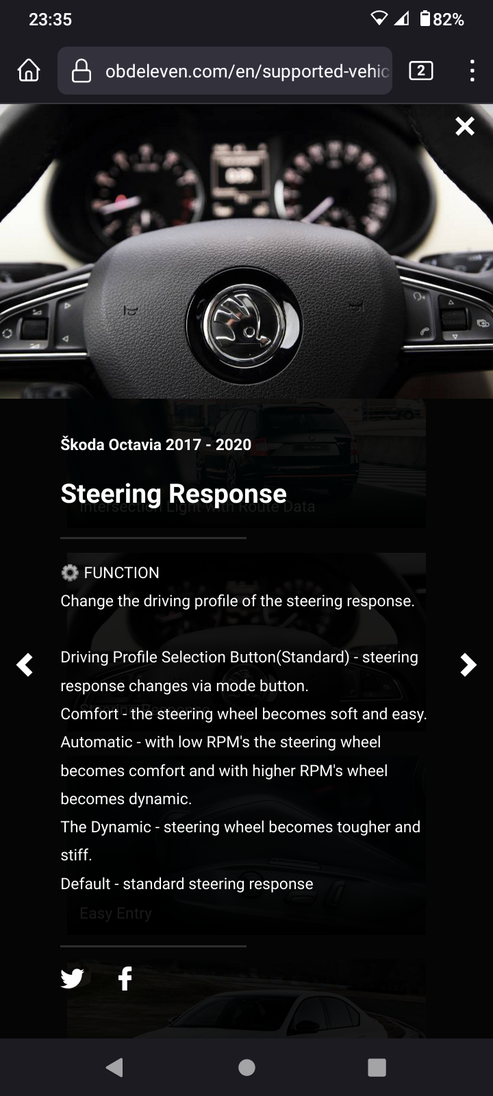

Suggestions on Offset for 'heavier' steering feel /scrub radius etc etc
@langers2k You may be right, however Obdeleven has a one touch app that seems to claim otherwise. I cannot vouch for whether this works or not, the OP should visit the OBDeleven forums for further information.

- Suggestions on Offset for 'heavier' steering feel /scrub radius etc etc
Do you know that steering assistance/weight can be changed electronically using a tool like VCDS? No don't know whats involved, but plenty of VCDS, OBD eleven experts on here.- Strange humming noise from front
