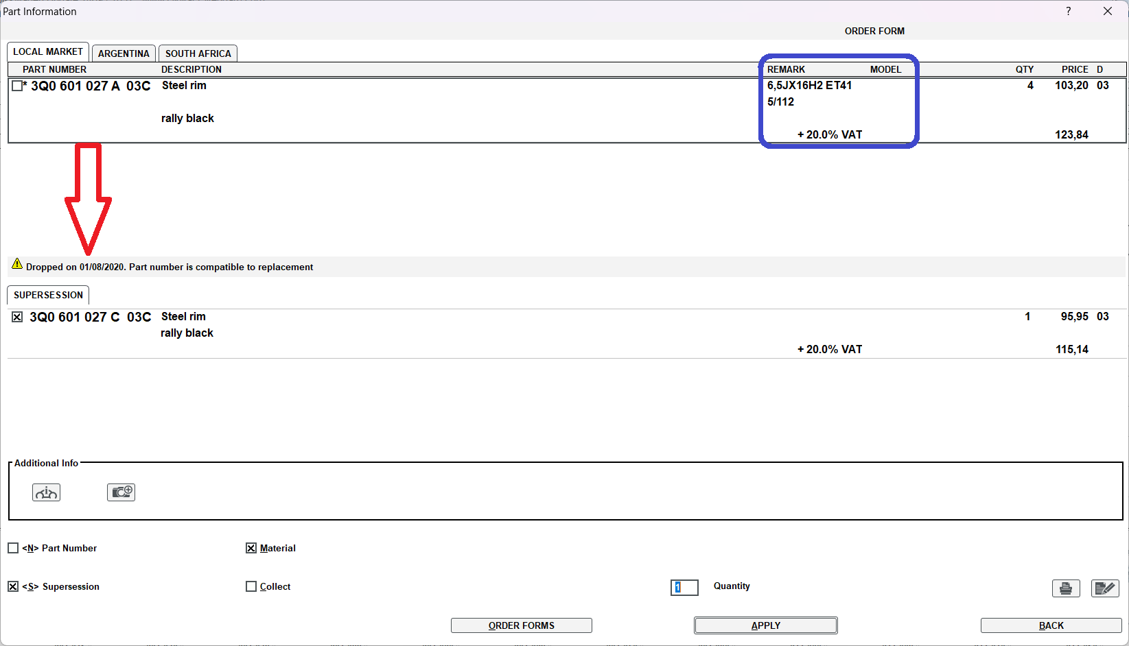

  19. Albertville are 8J X 19H2 ET41 for reference Someone will check this, but this should be the full size steel you need.

  23. So many online catalogs/eBay listings are pure bogus. They often say they are compatible, when they aren't at all (not saying in this case they ain't) GiGo = Garbage in Garbage out was how I was taught PC input.
