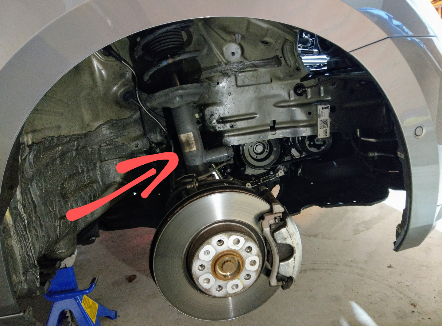

I looked at ur pics, but none were locked closely inside the wheel arch.
That's wat I'm trying to b certain about - that's it's either physically a different shock unit, or it's the same but with software making the difference for Sportlines.
Below is how it looks.
Edited by JR RS

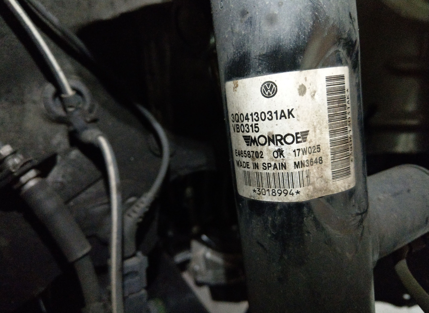

@JR RSIt looks like we all have the same shock unit 3Q0413031AK. This is mine:
This is @newbie69's one: (I can see _Q0413031AK)
So, if there are differences between L&K DCC and Sportline DCC, it has to be through software. Maybe it's set different due to the 10mm lower suspensions on Sportline?
I never believed the Sportline would have a different shock (hardware wise) from the L&K and the pics show that they don't, it's the same 3Q0413031AK damper used.
Considering the DCC's capabilities though and how much it's able to vary compression and rebound settings between its Comfort, Normal and Sport modes already, it wouldn't come as a surprise to find out that it's set up with slightly firmer settings in the Sportline, at least in Sport mode.
Thinking about it it doesn't make sense not to, considering the car comes with different springs, so a slight adjustment of the damping to match those would seem reasonable.
Still, this is all guessing. I wonder whether there could be any module coding comparison, i'm no VCDS expert though...

Do you mean if you can use the same pads on the Octavia? I believe you should as from the schematics, it seems the "top mounts" at the rear (item no.5) are the same part 5Q0512149A for both the multi-link and torsion beam versions.
In both setups the spring and shock are placed independently anyway.
1.thumb.PNG.4fa14092c95b7b11c9230c28136c1746.PNG2.thumb.PNG.ece2ab8aa1e26eb514a7238afc3e96ad.PNG
That's awesome thanks. Just need to find time to climb under the car to see what the original one is like and how much work. Imagine it's a jack up - bottom shock bolts out - springs off job. Should be easy enough provided the bolts aren't crudded too bad.
