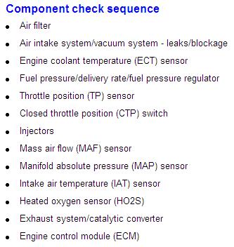

OK, let's not get carried away with head gaskets - topping up every 6 weeks isn't too bad. I admit, you shouldn't have to top up at all, but our dads would have put up with that no worries! As has been mentioned, a blown HG will cause mayonnaise under the filler cap (water into oil), or grot in the expansion tank (oil into water). In the case of the Fabia, a likely source is the seal round the radiator fan switch - not difficult to replace. As for the poor fuel economy, try these:
The filter is a good starting point, and I did a guide for the coolant temperature sensor, here. HTH :thumbup:

I really would have a go at the coolant temp sensor yourself: it's a piece of cake on the 1.4 MPi - fifteen minute job, and most of that's getting the engine cover off and back on again! It's a known cause of poor running, and they're one of those parts that go eventually anyway (probably about 4 or 5 year life), so if it doesn't fix it, at least you'll have warded off that particular 'timebomb' for a few years and saved yourself the labour and extras (a garage will drain and refill your coolant, which really isn't necessary!) Plus they'll just follow that list I posted previously! ( ;) )
