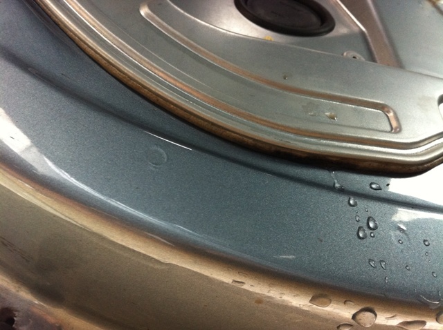

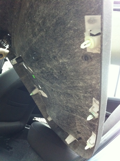

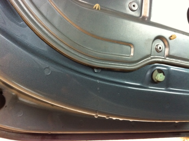

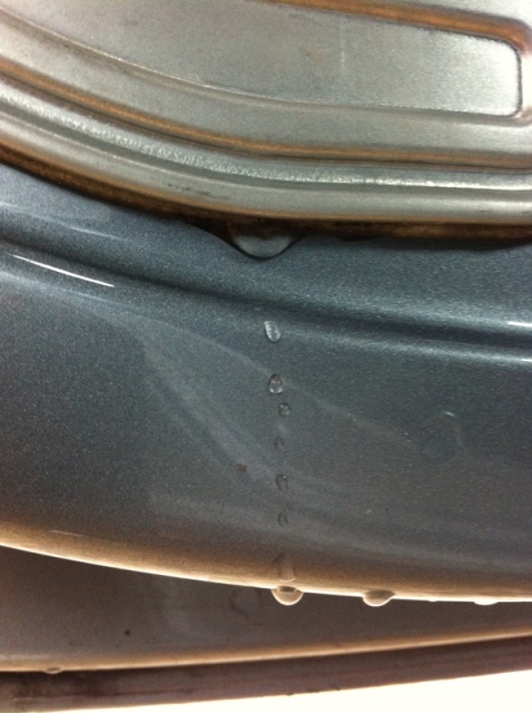

I had the same problem today. After the epic rain we've just had. it left me with a lot of water in the rear passenger foot well and a little water in the front passenger foot well.
The problem I found was the rear passenger door card was leaking water.
I used this video:
A couple of thing to keep in mind:
1. Be gentle when taking off the trim. It's best to buy some spare door card clips because they do break. Just search "skoda clips" in eBay. There are 7 clips on one door card.
2. After detaching one clip, get your fingers in between the door card and door and give it a good yank. This should pop off the other clips.
3. If the original seal is wet, try to dry it off as best you can.
4. A tell tell sign that your door cards are leaking without doing a test is to check the colour and condition of the original seals.
Take a look at the pictures I took of my car:
This is where the leak was coming from. As you can see the white spongy seal is rubbish & discoloured by mould, swollen and leaking water.
This is what the back of the door cards look like and where the clips are positioned. The clips at the bottom are located at the bottom of the door and the top clips at the top of the door.
