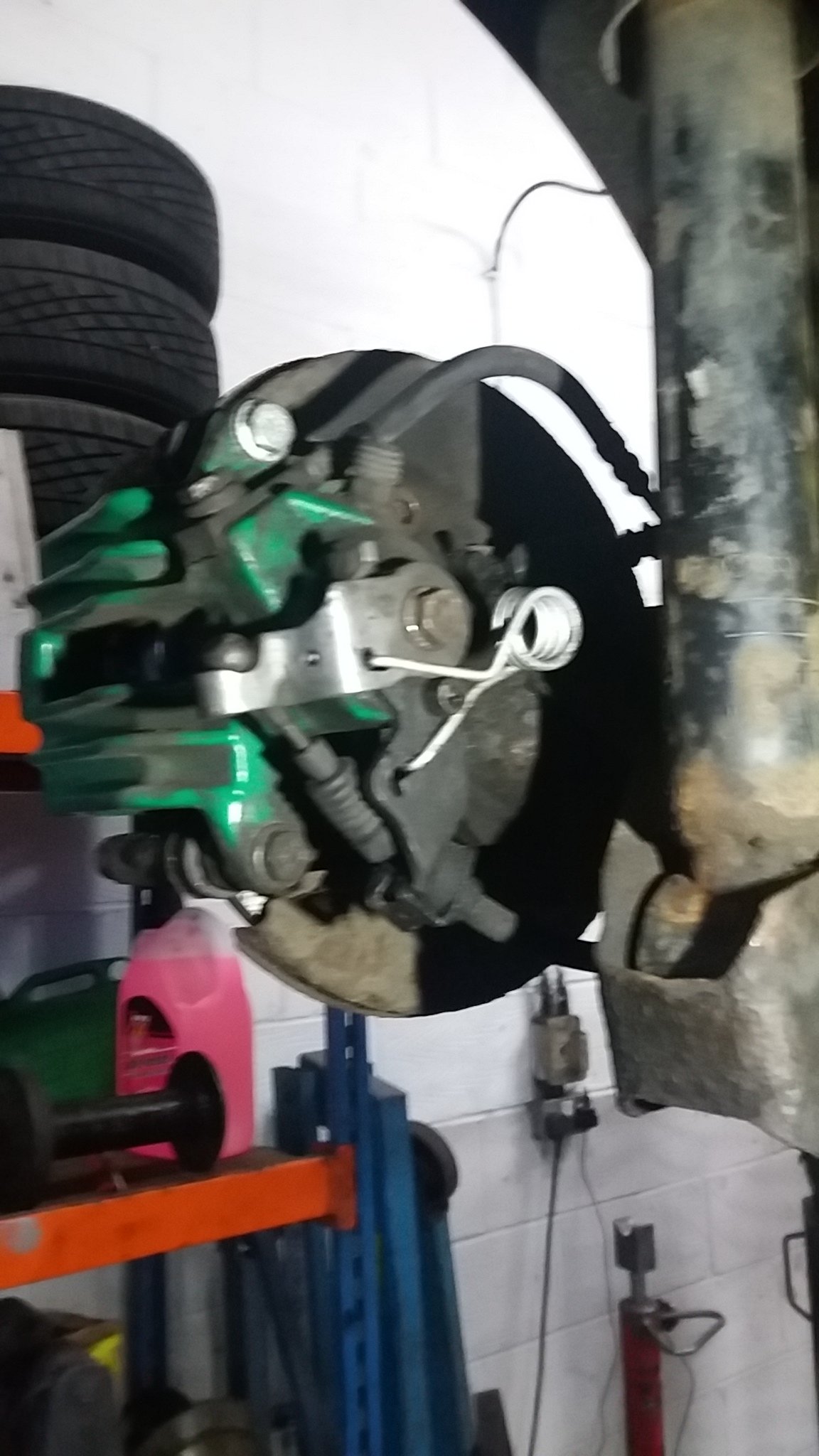

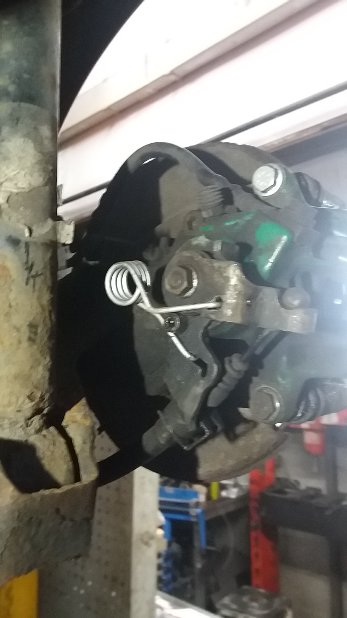

    1k0 615 295 left spring 1k0 615 296right spring i had this problem, these are part numbers of an audi a3, they fit on to the rear handbrake lever to pull it off fully, i'll post pics up soon
  • Have just put the return springs on my 05 Fabia vRS:- 1.Reverse up nearest convenient dropped kerb, to give yourself a bit more room under car without resorting to jack out and wheels off. 2.Fit fla

No that's the point they aren't fitted as standard to the Fabia vRS. They are fitted as standard to other cars with these calipers in the VAG range though.
They are only a couple of quid each and take 5 minutes to fit the pair with no need to jack up the car etc...
I think that the correct way to say this is "No they are not fitted to any VAG cars that share this platform - they are used along with different callipers on bigger/longer cars in the VAG range". I've always guessed that it was the lack of "stiction" on the cables on the smaller/shorter" cars that VAG thought made these springs unecessary on new cars - could be wrong though!

Just replaced wife's late 2002 9N Polo 1.4 16V 75PS SE 106+K miles with a new 6R 6C1 Polo 1.2TSI 110PS SEL - and yes I have fitted a of "7H0" external return springs to the rear calliper!  It took a few minutes and bad words, I obviously forgot what I did about 6 years ago!
Just fitted rear caliper springs which I thought had been taken off anyway just squeezed them together used a plastic tie to bind them then fitted them, big thanks for this thread. Good price on the springs cost under £5.

Only just had this problem appear on my 2004 VRS. Ordered the part numbers on Ebay from Rainworth Skoda - £9.98 including VAT and 48hr tracked delivery.
Took literally 5 minutes to fit both sides without jacking up the car and the problem is fixed.
