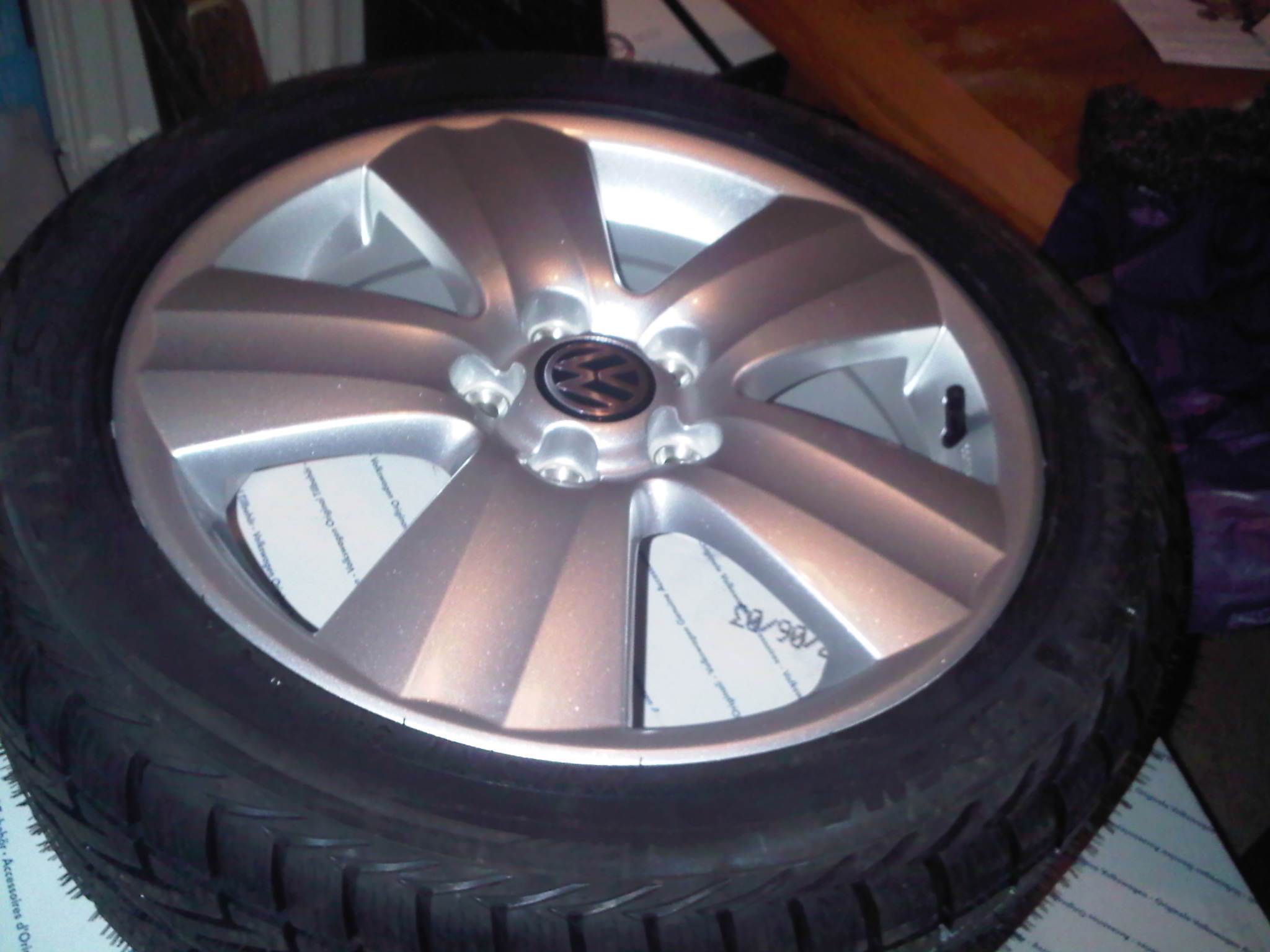

I purchased some 17" wheels for my winter tyre's but you have to bear in mind you can not get standard snow chains on with them. Got them new off ebay for £249 and are simple 5 spoke alloy so easy to clean.post-50203-12619116278327_thumb.jpg
Not the cheapest way of doing things but should look ok and give good grip.
