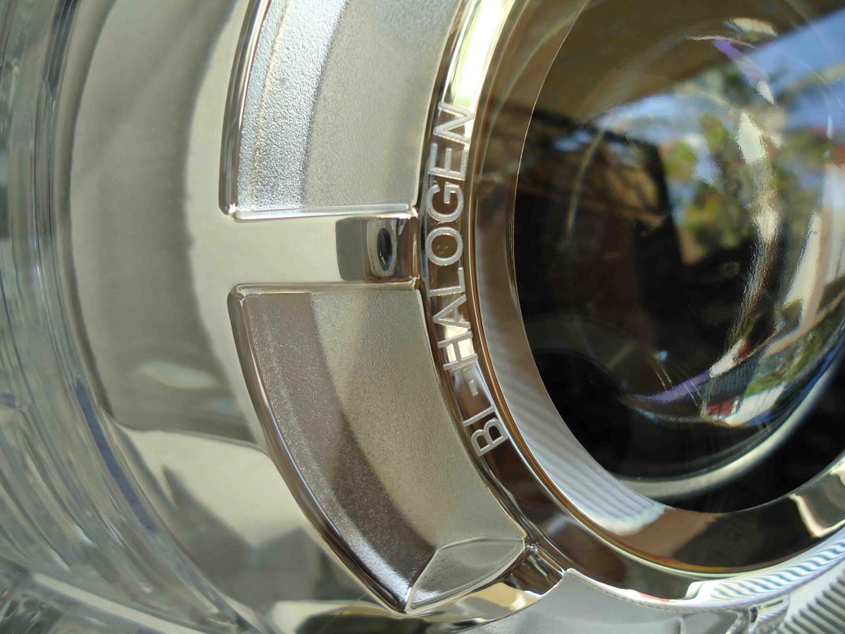

I have a Skoda Fabia TDI (Elegance), 2010 model. The car is factory fitted with projectors with Halogen bulbs in it. I want to replace them with HID. But when i looked closely i saw "BI-HALOGEN" engraved on the projector rims, so i want to know are these designed only for Halogen bulbs or a HID kit can be installed in it? I am poasting a picture of the headlight. Please have a look and guide me.

Bi-Halogen has a 'shutter' that swaps your dipped beam to main beam. You can probably hear them click when you activate the main beam or 'flash' your lights.
Fitting HID to these units is easy. Just follow the guide above but if I were you, I'd invest in a decent kit.

Yes, the VRS projector serves main & dipped beam by means of a shutter mechanism.
