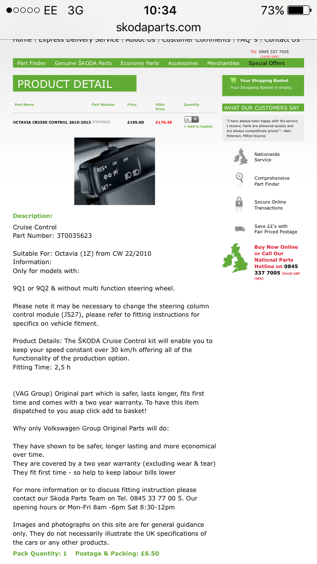

Well what a good post about cruise control. I am going to do this retrofit shortly for my 3 annual trips to the Isle of Lewis.I recently bought a Octy 1.6tdi on a 62 plate.As cash very tight,wasnt going to buy a car but this was a bargain, I need to do it myself or with slight assistance to keep costs low.
I could do with idiots guide instructions as someone mentioned a pdf on here as I,m worried about the airbag issue and the actual removal of the stalk.However first things first I suppose is the actual part. I have seen a few stalks on ebay on part number 1kO953513A. Before I actually bid or buy one do you guys think this will be okay for my car.
If anyone has good instructions and recoding info that would be great. I think I can get access to vcds as I work for a commercial vehicle dealer but if not may ask for assistance on here. I definitely need cruise control as 2 speeding fines now clear but with the police in Scotland having not a lot to do on the clear expansive motorways and A9 its a must for me.
Cheers guys
David
Any info on above post would be appreciated if anyone about
A 62 plate Octavia has a later type stalk and control module arrangement I believe so the stalk from earlier cars won't be compatable.
Edited by Tech1e
You need to be a 100% sure before you buy any parts.
The Octavia Mk2 used three different types of stalks
2004 - 2010 uses a single stalk 2009 - 2010 can only use a G version stalk
2010 - 2013 the type you have fitted needs to be checked as there is a 5K0953549 Controller type and a 5k0953569 Controller. The parts program will state that the car needs to be plugged in to the diagnostics to identify which is fitted.
It is important if buying a 569 version that you don't buy a Passat version as that will cause some issues
