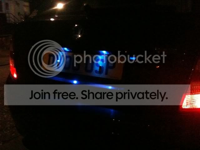

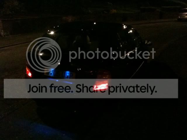

Are my lights illegal?
Hey, what's you opinion on my tailgate regi lights do you think they are illegal or ok?

I was rather under the impression the numberplate lights had to clearly illuminate the whole numberplate? (Don't really know, just a gut reaction) I guess the easiest way of finding out would be to take it to your friendly local MOT centre and ask them in return for some biscuits?
Yes..Totally illegal
Blue is not to be used for numberplate lights
Even if they were legal...They look dreadful...IMHO of course
Maybe. I'm not sure that a steady blue light at the rear is illegal (it is legal but chavvy at the front!), or that a numberplate light must be white. I would say that those lights are grounds for a pull, and possible breath test and/or MOT whilst you wait even if they are legal though!

You're bound to get pulled a lot like that.. Especially because it's at the rear, not like you've got it on the front and cops see it as they drive by but cant be bothered to spin round.
If they're behind they'll see it a mile off and be quite happy in earning a bit more money :)

They might be legal as far as interpreting the quote from the website, but I'm sure that there will be somthing somewhere that they will pull you on with regards to been able to clearly read a numberplate from a certain distance at night time. In your top photo you are no more than 15ft away and it's hardly readable to me. You are asking for a pull IMHO. Not a big fan of how they look cosmetically either. :doh:

i would say that they are illegal as i understand it they have to be white and illuminate the whole plate :|

Defo illegal blue lights for a start and your not allowed blue lights! plus all of number plate needs to be lit not just two quaters!
