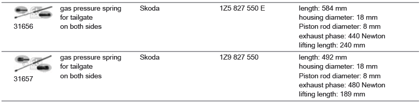

Okay, update. Cos this keeps raising it's ugly head and it's winding me up not knowing what the best to use is, I've been on the phone to FEBI/Bilstein and the guy there says they do have a total list of all their boot/bonnet struts with all dimensions.... but it's is a BIIIIIG document! He's gonna email it to me and I'll let you guys know which struts appear to be the closest so which are the best bet to experiment with.
Spoke to him initially about the Octy, Exeo & A4 (B6) struts, dunno about the A4 ones but the Exeo ones are really close in size and 30nm more powerful! Those crazy dutch b@stards might be on to something??!!  :rofl:

This is FEBI's listing for the octy (hatch then estate)
This is the Renualt equivalent that I think you fitted Radders...
Edited by blackspaven

YOU ARE NOT GOING TO BELIEVE THIS!!!!
Okay, so I'm a way down the FEBI list and there are MANY possibilities already to getting the estate working with a stronger strut, a lot of them being Vauxhall, strangely enough, but then one sprung out at me that according to the specs might be a surprisingly perfect answer:
Mk1 Octavia VRS hatchback!
Turns out, apart from the lifting length being 4mm shorter, the dimensions are IDENTICAL to the MkII estate, but it's got 565nm of force! Has to be the VRS version to have that force though, the non-vrs version is only 515nm, which is still stronger, although I suspect the extra force is to counter the VRS having the boot spoiler.
So if anyone has a Mk1 and want to give it a shot, they might be pleasantly surprised. How absolutely f*cking ridiculous!! :rofl: :rofl: :rofl:
(if it's STILL not enough with a second hand strut, there are quite a few stronger alternative... but we don't want the boot to fly up like an ejector seat I'm guessing!! :))

Oh, and read carefully, it's not a MkI estate, it's a MkI hatchback, VRS ONLY because the boot is heavier due to the spoiler which subsequently makes the struts needed to lift it to be stronger than the non-vrs model.
Think there's a fair chance, I was more concerned whether they'd always work or fade like other ones. the Laguna ones earlier in the thread work fine but I have no idea if they'll last once they start to age, and I've not seen an old model in the scrappy to test that theory yet. New ones worked well, check earlier in the thread, but I suspect brand new standard octy estate replacements would work for a while before failing too.
