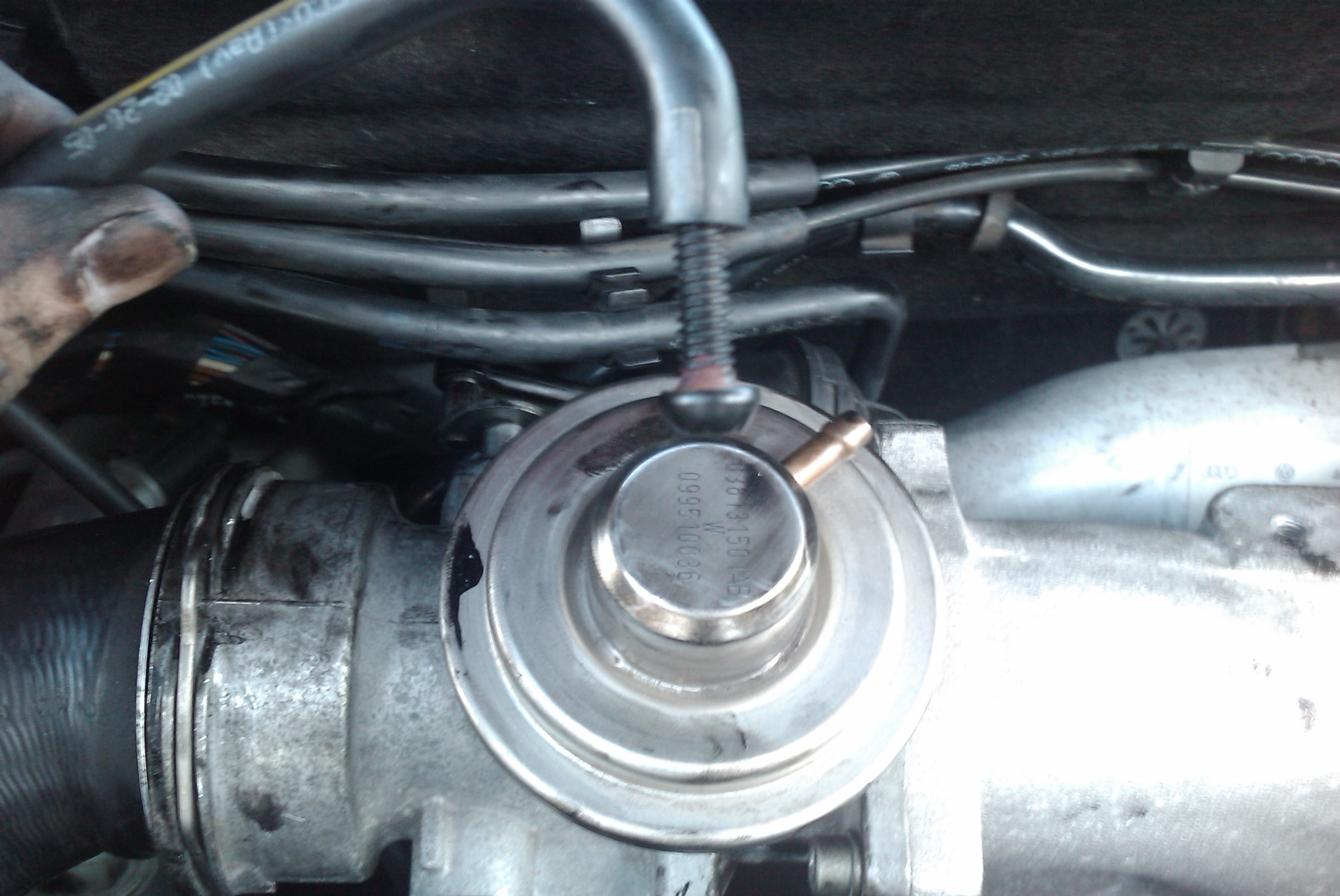

can i just ask to do an egr delete do i remove the pipe from the UFO looking thing at the top, or do i remove the pipe from the pluger looking thing on the rear side ill supply a foto if you could tell me if i have dont this right it would be hugely appreciated
Top hose from the UFO and leave the other hose connected. Your picture is the correct way :thumbup:
