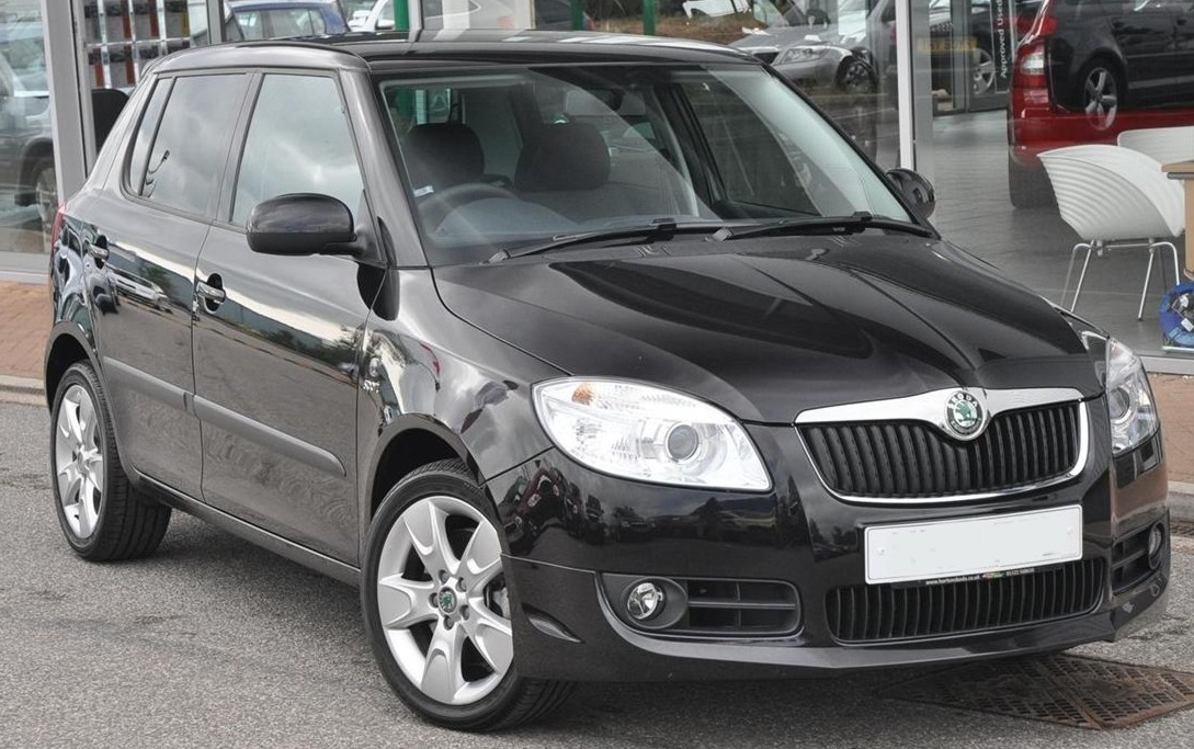

1.9 TDi Sport won the day :thumbup:
Luvly Jubly you won't go wrong with oil burner :D :D :D
Brimma, that's a beaut!
Thanks - collecting on Friday :thumbup:
