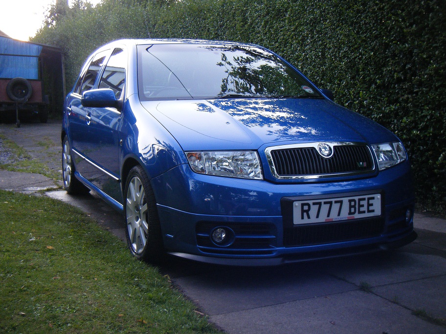

I always used to use Meguires NXT on mine...I had a 2002 Octavia vRS, a 2005 Fabia vRS and a 2006 Fabia vRS all in black magic.
Have to give it a top up every few weeks, but it's no drama with it being so easy to apply and remove.
Here's my Fabia that I have just sold:
And my old Octavia:

I'm the person who's just bought Doll's Fabia...
Just given it a full detail. Paintwork went as follows:
  • Clay (Bilt Hamber AutoClay and Chemical Guys Synthetic QD as lube)
  • Machine Polish (only needed a light polish so Menzerna Final Finish on Meguiars Finishing pad applied via Megs DA)
  • Glaze (Meguiars #7 Showcar Glaze, gave all my Poorboys Black Hole away :()
  • 2 coats of wax (Dodo Juice Supernatural)
The finish should last over the winter, will just need to top up the wax every 2-3 months and use a gentle wash method every week to wash.
Couldn't get many good pictures, but I think this one shows the shine quite well...
