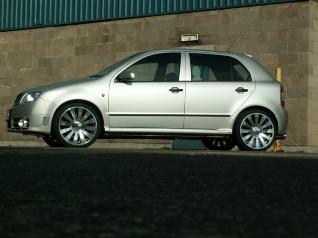

IIRC they were 18" Audi A8 Reps as below

My ears were burning. You can go 19 x 7 if you really want! I ran 18 x 8 A8 reps for a while, and as others have said, the performance and handling suffers considerably. I tried a few combinations before settling for the 17 inchers you have currently.

ive got currently got 18's on mine 18x8 ET45 and its lowered on coilovers, tyre size u would need is 215/35/18, theres no rubbing on rear arches only sometimes on the front arch liners (plastics) but that depends how low u go on the fronts, mine are wound down all the way on the rear and half way on the front. ride quality is harsh and you loose performance, apart from that the car looks the part :rofl:
ive got currently got 18's on mine 18x8 ET45 and its lowered on coilovers, tyre size u would need is 215/35/18, theres no rubbing on rear arches only sometimes on the front arch liners (plastics) but that depends how low u go on the fronts, mine are wound down all the way on the rear and half way on the front. ride quality is harsh and you loose performance, apart from that the car looks the part emoticon-0140-rofl.gif
On an SE? :o
Can you show us some pictures? :)

sorry for the crap quality but heres a quck pic, i will post some more tomorrow
