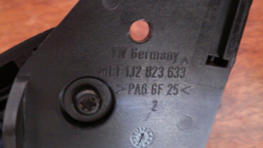

1J2 823 533 C You will also need a new mounting bracket 1J2 823 633

I can find the handel with the above part number (1J2 823 533 C) on the Bickerton Skoda site but the part number for the mounting bracket (1J2 823 633) is not giving any results, so is it correct and if not can some one give me the correct one please as am fed up of my handel coming off every time I try to open my bonnet so want to replace it with a new one?
Also, is it easy to fit the new one and can any one guide me to some instructions on how to please, if possible.

Hi yes it is correct...

Thank you.
Have now found the bracket but do I take it that I need to replace the bracket and the handle at the same time?
Yeah the bracket goes on first and the handle last when the foot rest trim has been re-fitted.

Is there a specific way of removing the lever? Do you just pull it towards the centre of the car or is there a clip or something?
Posted ImageYes there is a clip, the pic shows it removed. I didn't have to remove the clip to remove the handle, it just came off in my hand lol I imagine it would be hard to remove the clip due to the position of the handle.
