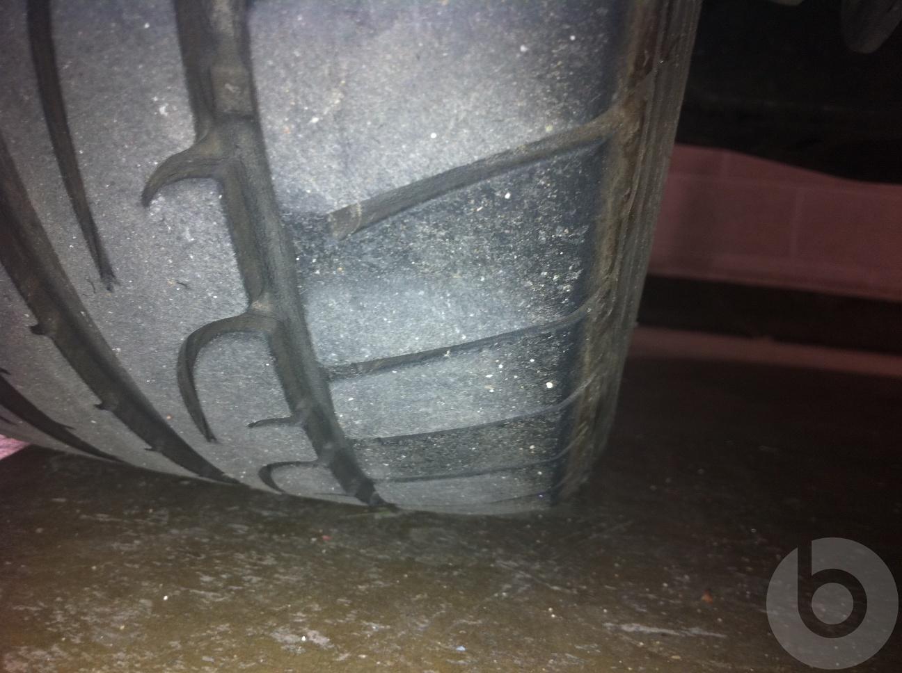

have you checked the very inside edge, as already stated mine looked fine apart from the baby smooth inside edge?
Although you can see the low bits due to sawtoothing, the inner edge looks OK to me:
i agree it does, mine was baby smooth.....maybe yours is not so far out??
