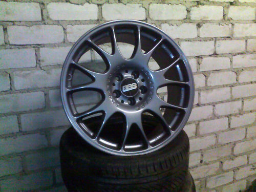

These?
Edited by skodaphile
Thee offset's a bit low on those CHs. You'd be better off with the CH026 (ET50).
I do have some 15mm spacers. The lower the ET the further they stick out, is that the right way round?
15mm spacers would even bring the ET back to 20.
The lower the ET the more they stick out is correct.
8.5" would need an ET around 48.
