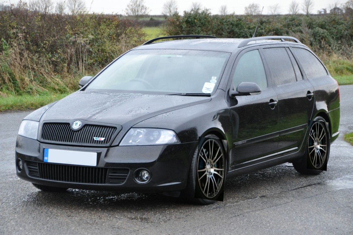

Can you post some pics of our Turinis? They look really nice
In Bryan's other wheel thread I posted some pics:
Direct post link
I do have some others, if you'd like to see them...
