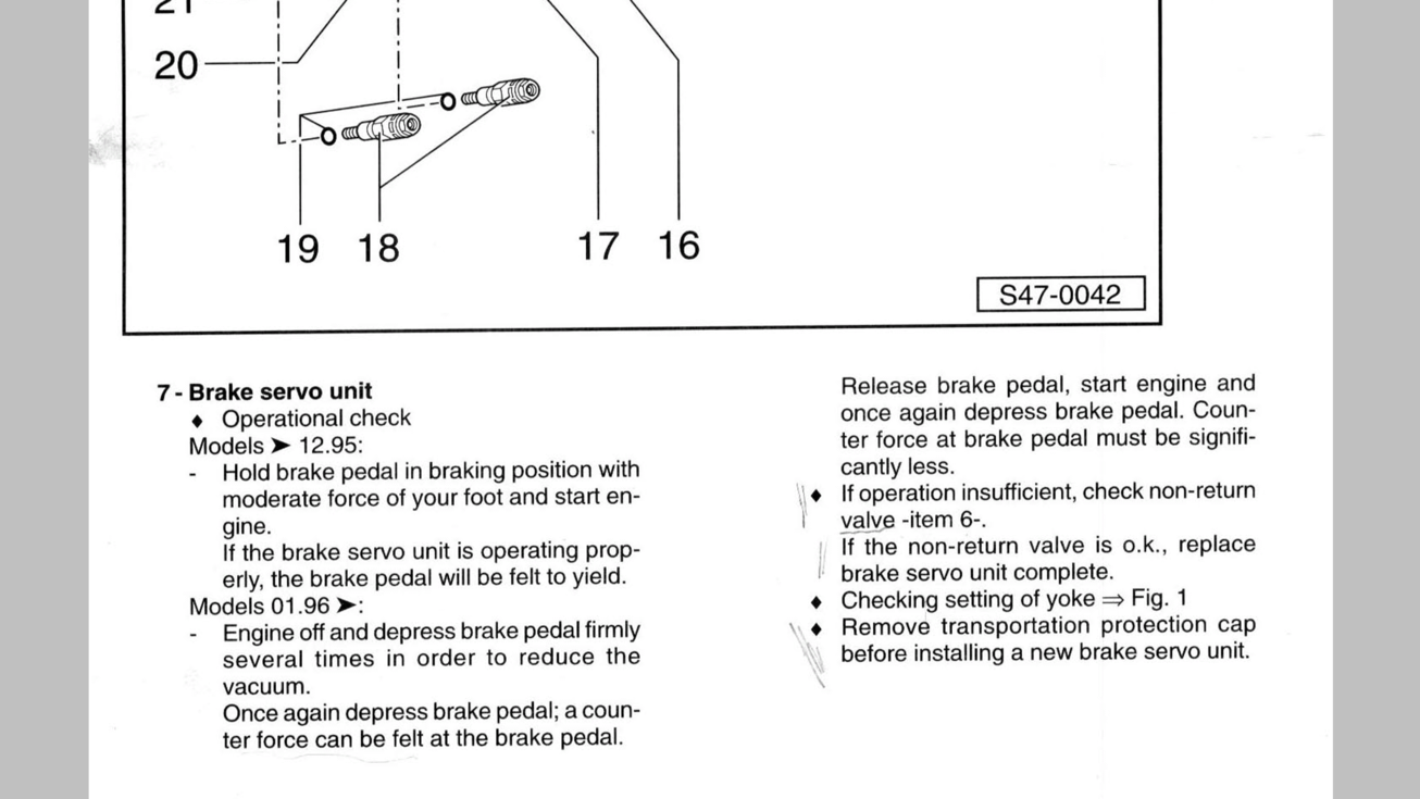

Still bad braking.... i was testinkg brake system according to the manual below and after some pumping , the pedal start to sink when depressed firmly ....so tomorrow i will have to check the non return valve
The brake pedal sinks if the system is either losing pressure from an external or an internal leak. Check for external leaks by looking at each wheel for brake fluid seeping outside or inside. Look also for cracks in brake lines and brake hoses. Internal leaks usually refer to a leaking brake master cylinder that it is leaking inside itself. The solution for the latter possibility is to buy a brake master cylinder repair kit (seals) if you're broke or buy a quality new brake master cylinder if you're rich and value your life.
PS The test shown in your illustration is for the servo brake mechanism.

I was testing as per manual and the brake fail so i thank to start from there....wrong?

So, rear left drum cylinder changed (and bleeding done as the shop said) but breaks still dont operate properly. No always the same behavior sometimes breaks quite good at first than slowly pedal goes down and i have to apply a lot more strenght to brake(like no servo); sometimes it goes down (like no servo) . And seems that is rev related : if i rev much seems that breaks better.....
Still to have the no return valve checked....

@Haladams thanks for ur message sometimes us usfull some rimg bell but my concern about the non return valve come from the skoda workshop manual and the changing of the brake pads was to be done because also Ricardo told me to check the callpiers and so i decided to put new ones.
