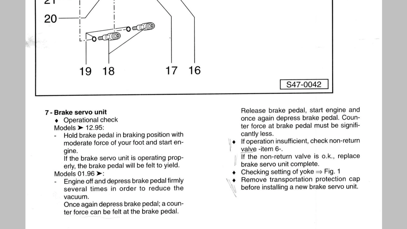

I did the workshop manual procedure of the picture below and it faild. The manual said to check non return valve, if it works , change the servo.
While driving i have a loss of servo help not braking strenght.  Because while braking , if the pedal sink of certain amuont of travel , if i press more the pedal the pickup brakes and stops.
