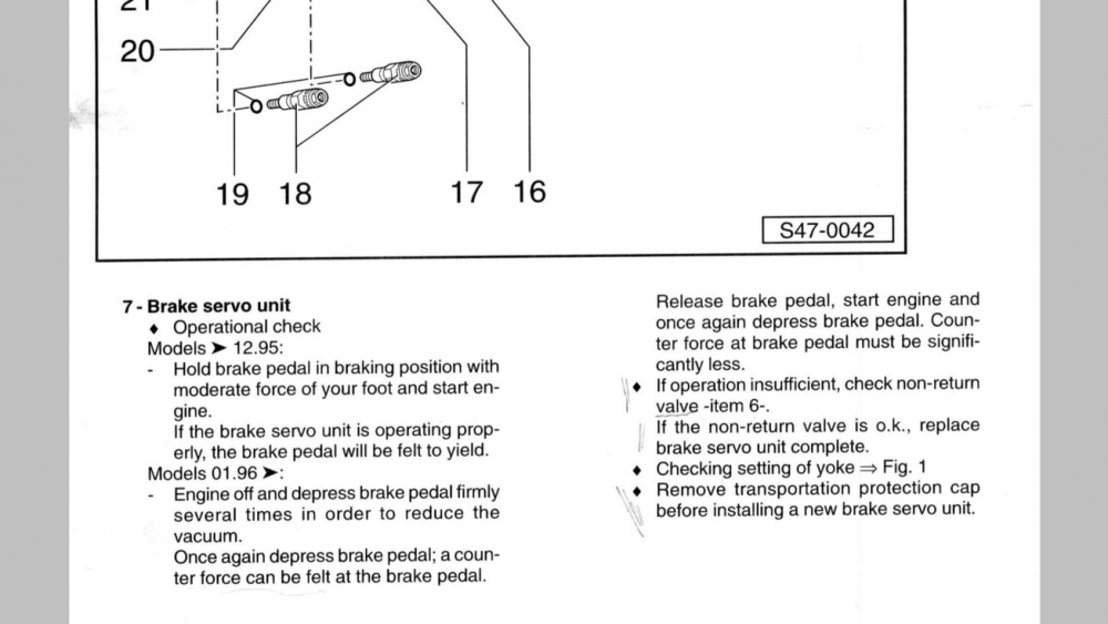

  • The brake pedal sinks if the system is either losing pressure from an external or an internal leak. Check for external leaks by looking at each wheel for brake fluid seeping outside or inside. Look al
