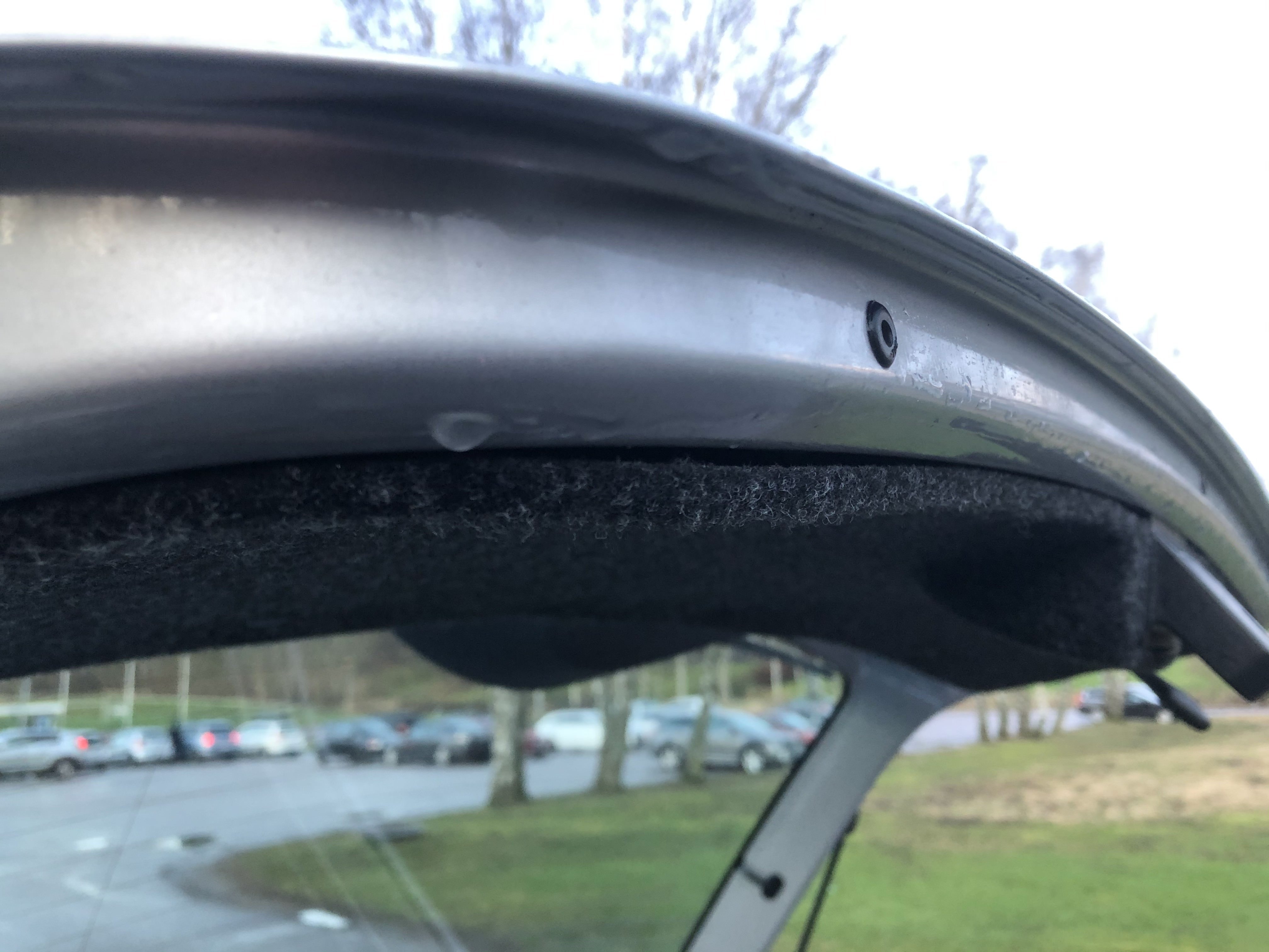

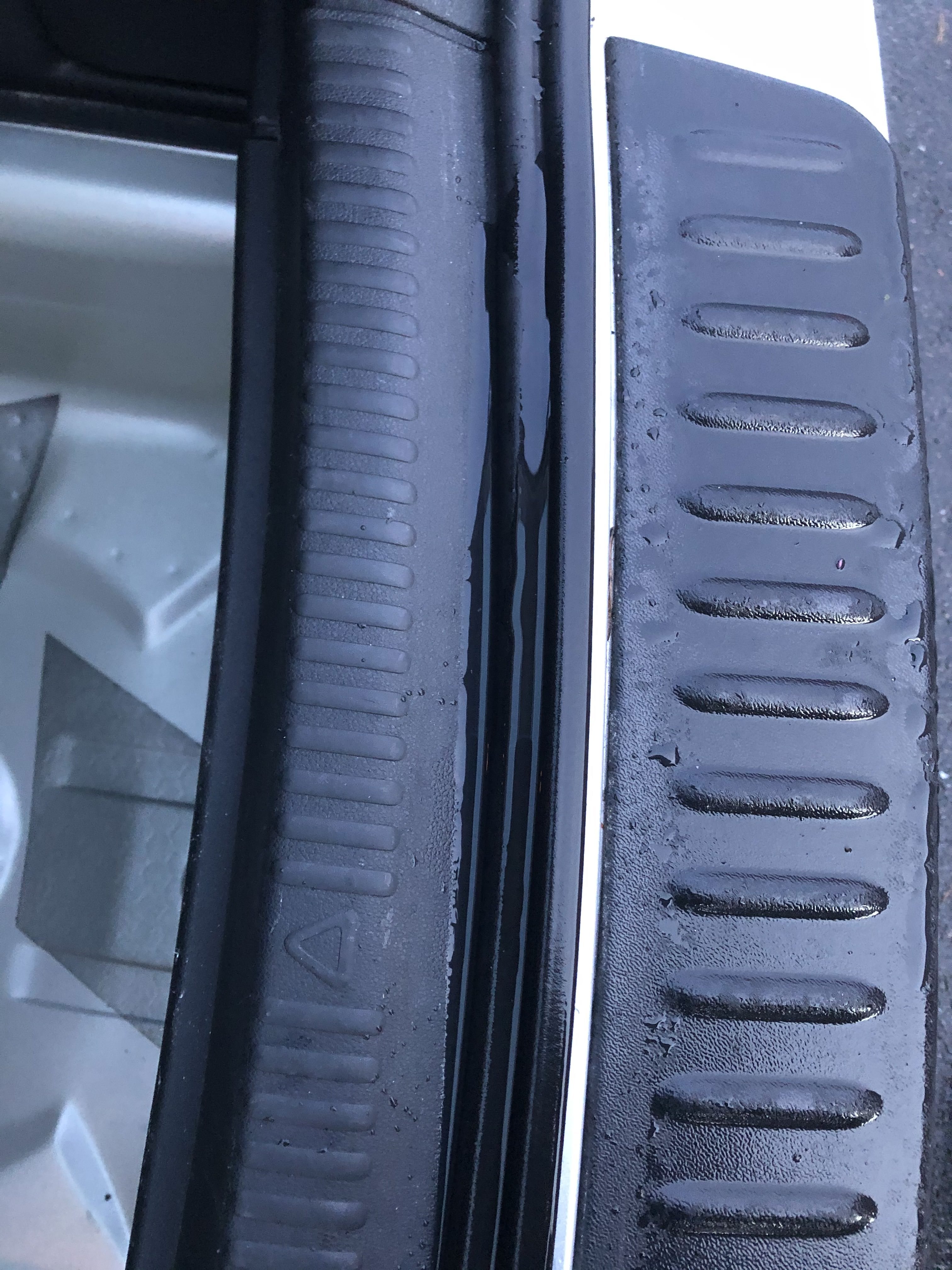

Hello @pist0nbr0ke  ! I have exactly the same problem. Water in the wheel compartment, tailgate carpet wet (just 1 inch from bottom and rest is dry - you can see it droping in the pictures attached) and rubber linner full of water that when goes over the rubber falls into the boot. I had the car for 2 years (2015 model) and never ever happened before. Now all of a sudden, after 1 week of -6 Celsius temperatures, a lot of water after 2 days of rain (i have not moved the car for 48 hs. It is rain water, not wash fluid). Have you solved yours ? how ?. I would appreciate. I can attached files and pictures. I own a Skoda rapid 1,2 thanks
