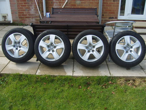

ok the seller said they were off an audi a4 2004 but thats all he knows so do think these will fit? cheers ryan
these are what i am thinking of buying
wheel
So these alloys should fit my mk2 octy vrs?

vRS_Pagey do you think the alloys I listed earlier in the post will fit as all the eBay seller has told me is it's off 2004 Audi a4 and it's a 5stud. Else I'm buying something that isn't going to fit. Cheers Ryan.
I would say there is a 100% chance they will fit, iirc the wheels I got were fitted to A4's as far back as 1997! And I am certain the sizes haven't changed in recent years.
