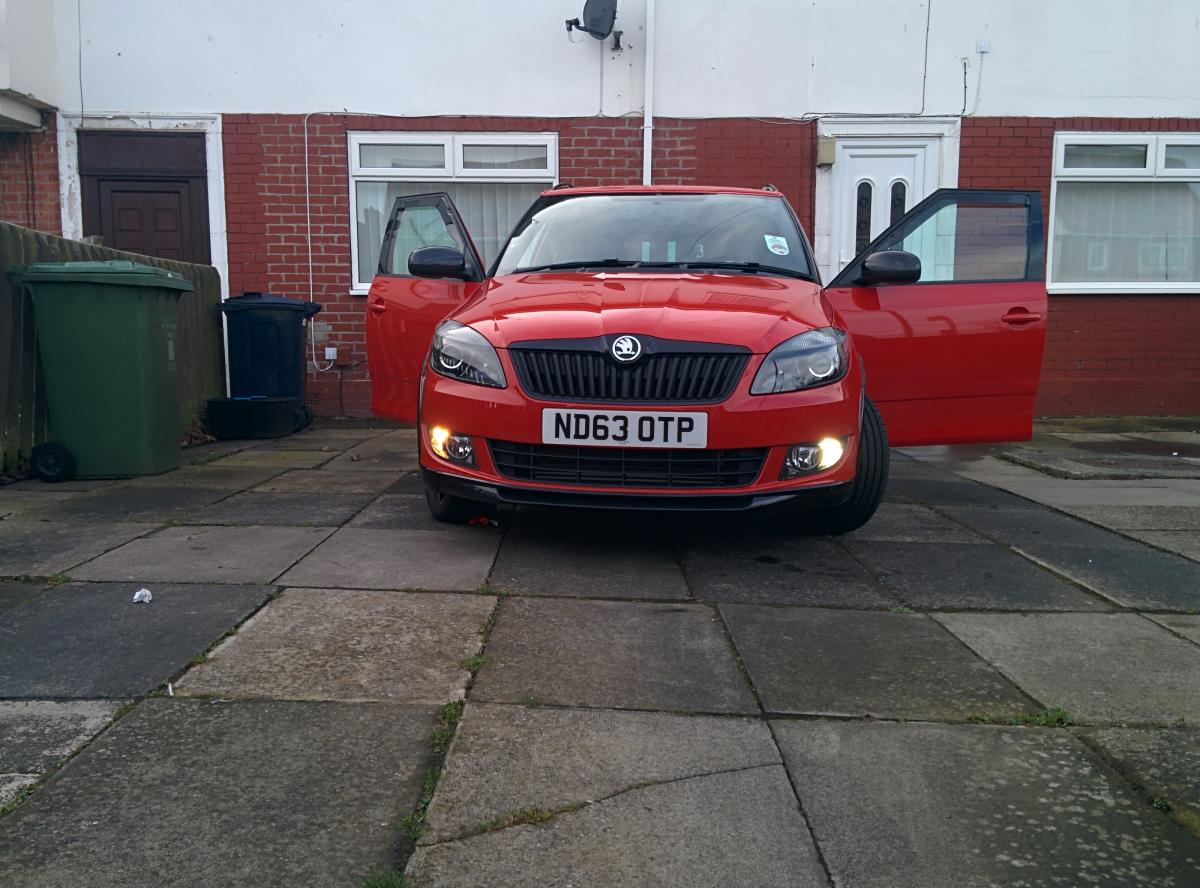

  • Here is a quick pic of my new sidelights. What do you think?
  • The true watt of a 5 watt-diode is 5 watt. They are however not pushing 5 watt through each diode, it's 1 watt in those lamps. False advertising is what it's called . I should know, I work with LED
  • I haven't seen them in full daylight yet, only put them in tonight when I got home from work. They seem to be brighter and emit light from the side of the bulb too so it makes use of the reflective ho

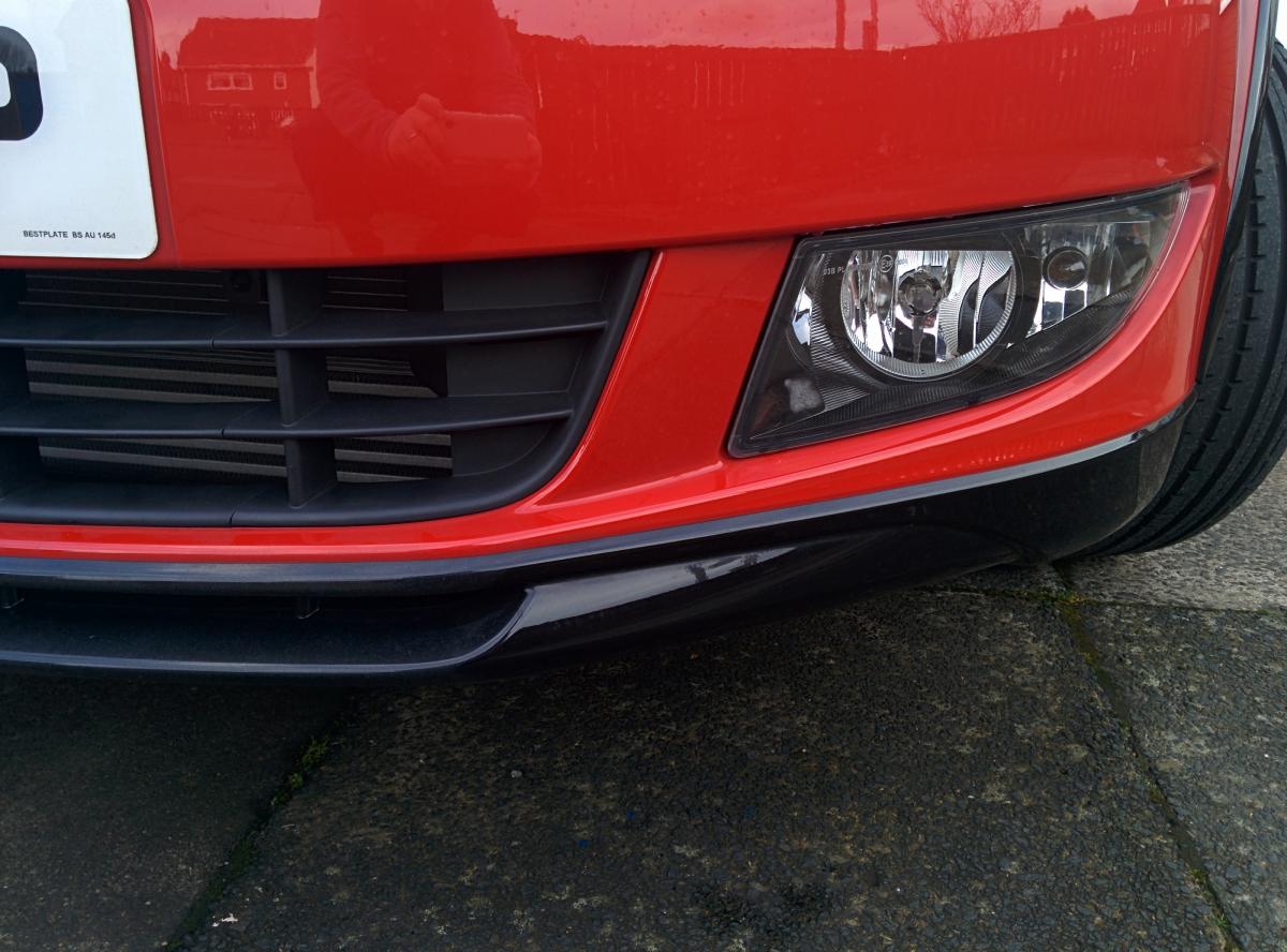

How do you get to the DRL's to swap them over? is it by taking the wheel arch liner off or through the lower front grill?
I have searched (honest) and can see plenty people changing the bulbs but cant actually see how easy it is or how to get at them
:angel:  :angel:
You pull the small black piece of grille next to the DRL off first then you push a clip on the side of the DRL then it should just pop out.
Swap the bulb then replace in reverse, should take no more than 5-10 mins for the pair.

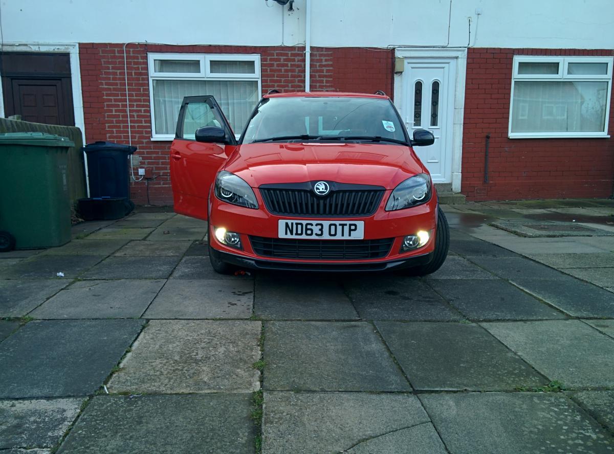

Here's what the difference is.
What bulbs did you get mate?? :)
I'm on the verge of doing this now the lighter times are a coming, so I'll be on DRL's most of the time soon!!
I would go for the chrome ones as they will blend better. The blue when the others are off may give a blue reflection on the housing??
