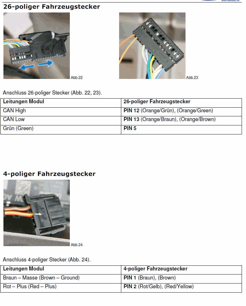

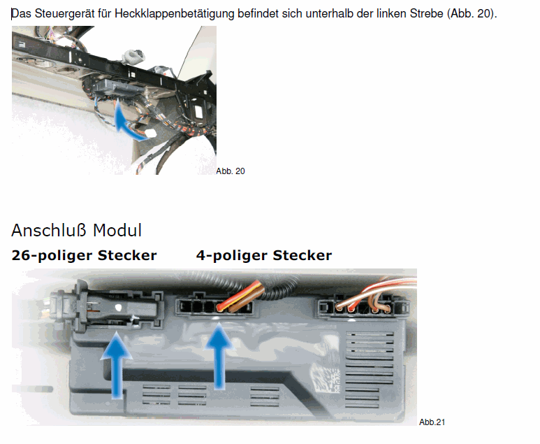

I attached few images to this post. I take it that Kufatec doesn't want the whole manual in the 'free' internet so I took a few screen captures which shouldn't violate their rights that much :)
For now I could only download German instructions but they are illustrated and wires are also in English.
The wires shown in the images need to be cut and/or soldered with the wires from the Kufatec box.

Yes, you need to manipulate the original wiring a bit. The Kufatec module needs to be connected in parallel with the trunk control module. I soldered mine and used original Skoda (TESA) wiring tape to isolate and make it look original.
