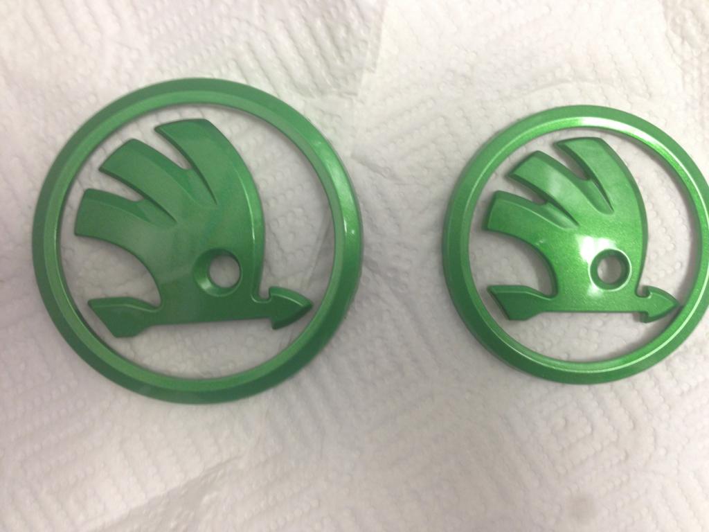

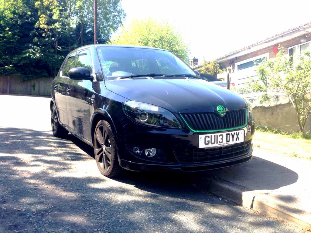

I'm doing something a bit different here, I have a Monte Carlo in black magic and have bought a chrome lower grill surround which has been sprayed in rs ultimate green along with my skoda badges, what is the best way to remove the trim without breaking any of it? As I want to keep it as it is expensive new?!
Some of the picture tutorials are helpful but the images are "removed by user or links are broken" do these work if I view it in my computer? Cheers guys post-99063-13732826700358_thumb.jpg
Not a Monte Carlo grill mod, something a bit different,
Followed confides step by steps, the pictures didn't work but all makes sense as you start doing it
