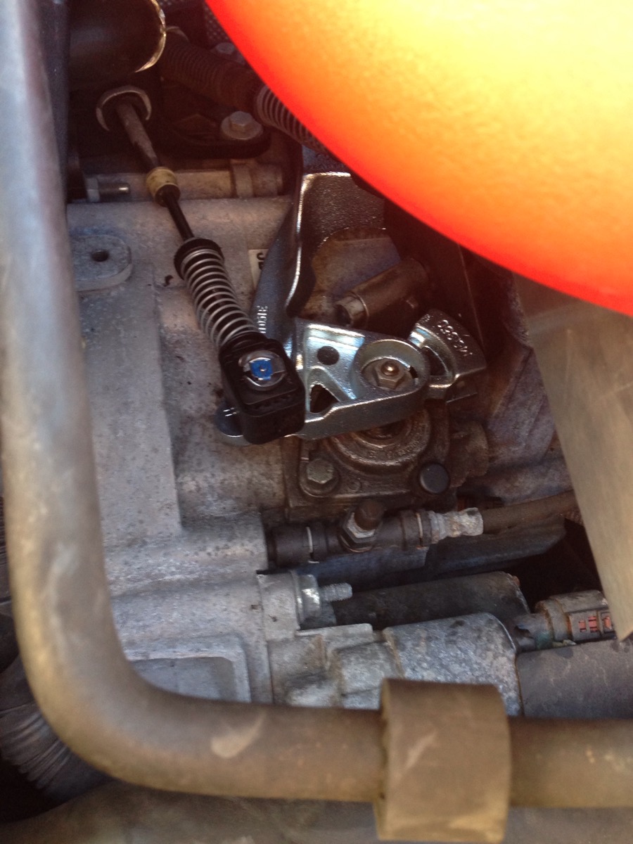

Did mine yesterday, took 8 mins.
1DF91492-6A23-46D0-A0B6-7487F666A774_zps
C621F16B-A65F-463D-87D0-EFB9752F06C9_zps
Did you not replace the spring as it still looks dirty? I stupidly dropped the plastic clip and it was somewhere in my engine bay playing hide and seek but got a small screw and bolt which went through the whole which now makes it even more secure than that clip.
Why would you change the spring?
If the air box and all the bits were out of the way, I still think 8 mins is a tad optimistic, unless of course your part of Red Bull F1 team!
Why? Its one 13mm and a push on clip? About 4 of them mins were trying to select a gear easy enough to remove it [emoji23]
Now add in the time for the removal of the airbox, pipe work etc.
One jubilee clip.

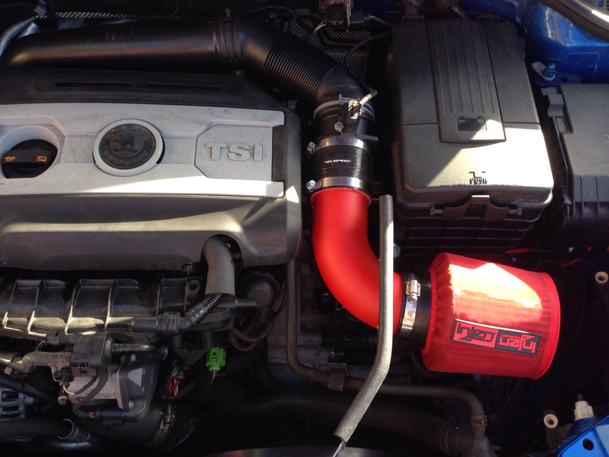

just fitted mine and also fitted neuspeed proflo which ive had for bloody ages
